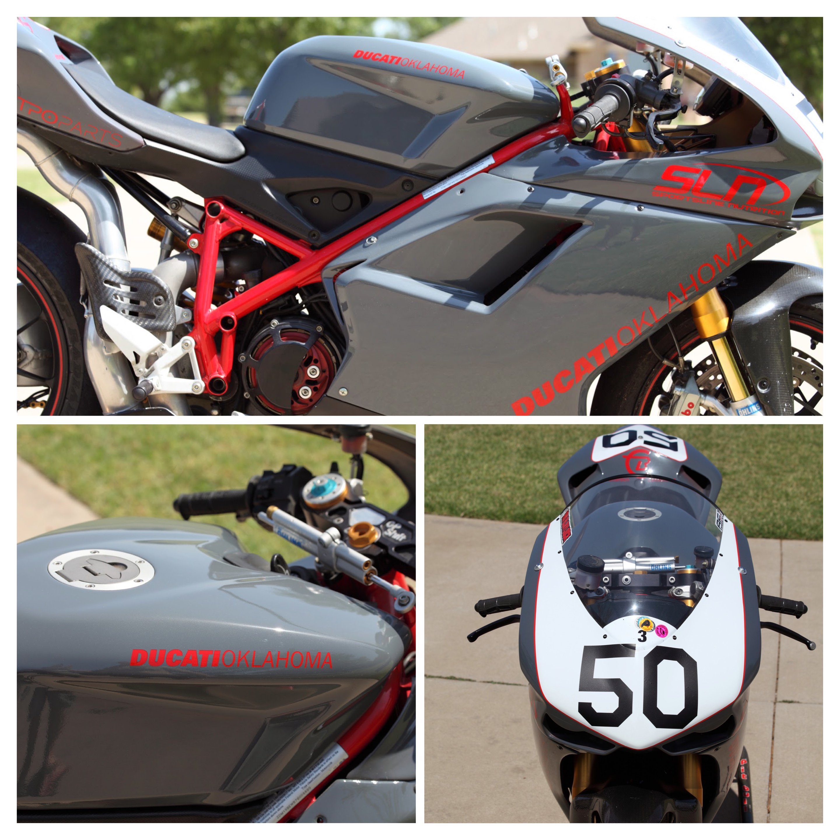

@Superhawk996 is telling the truth! The last paint job I did was definitely my best (cir 2011)

QUOTE(Van B @ Jan 19 2023, 08:44 PM) *
geez the old 1.8 L jet must be a bit of a let down after that baby. (IMG:style_emoticons/default/smile.gif) (IMG:style_emoticons/default/biggrin.gif) (IMG:style_emoticons/default/beerchug.gif)
