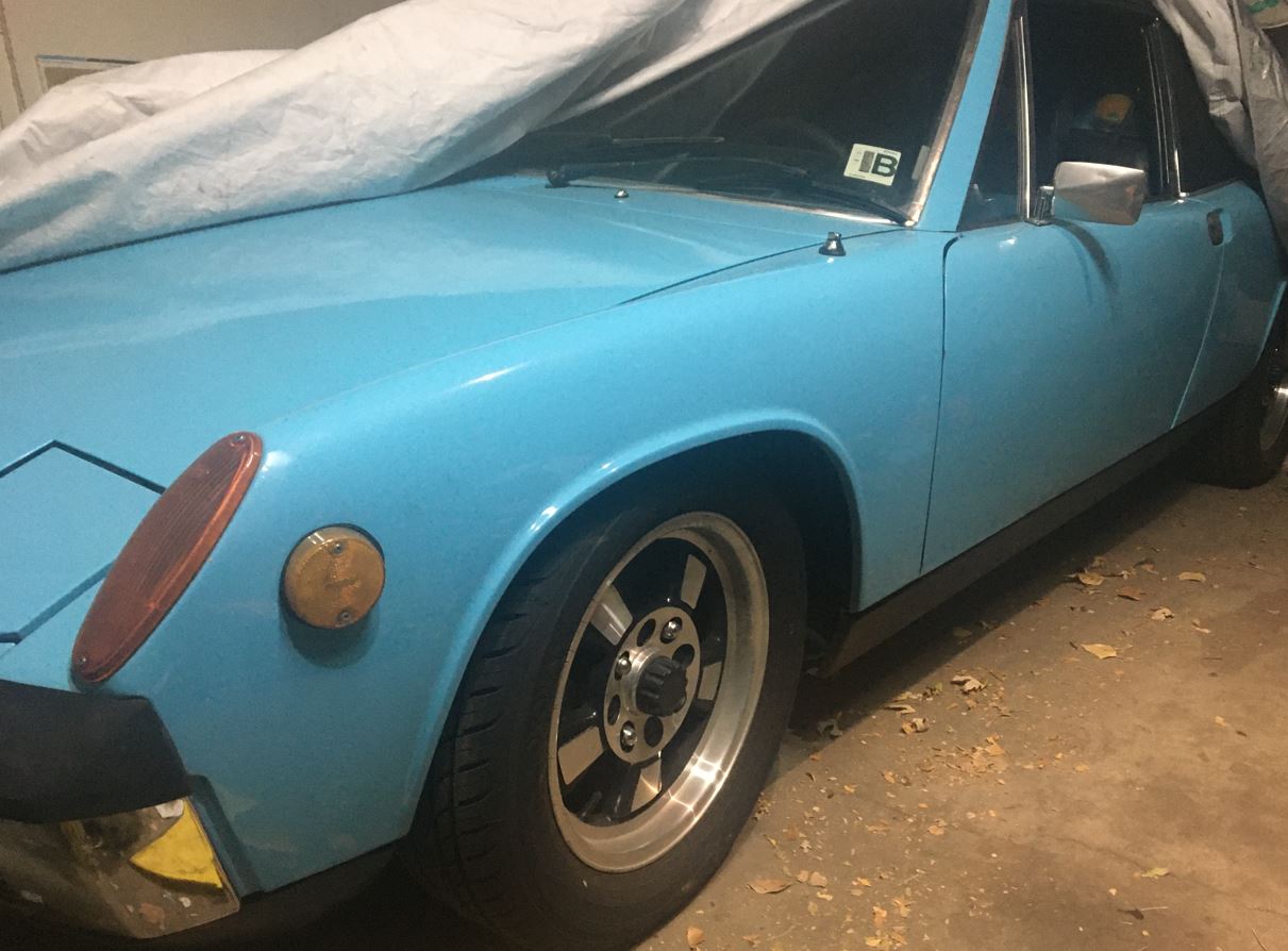

I purchased Gasurit from capital paint in Denver about 4 years ago to do some touch up and repaint the hood. I ended up with 55 line and used it as single stage without clear. In my case it was an exact match to my car which was repainted in the about 25 years ago with unknown paint but the color matched to the re-painted and unpainted areas like the trunk, Frunk and engine compartment as well. My car is Olympic blue.
