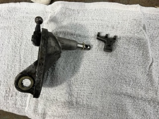

930cabman   Having the same issue and dis assembled it today. ...   Jan 14 2023, 06:09 PM
r_towle   Having the same issue and dis assembled it today....   Jan 14 2023, 06:48 PM
930cabman   Having the same issue and dis assembled it today...   Jan 16 2023, 10:33 AM
Dave_Darling   May? It will; it comes out as a unit. The rake h...   Jan 16 2023, 10:36 PM
r_towle   Btdt, no swearing required when in neutral. Got it...   Jan 16 2023, 10:54 PM
Dave_Darling   There's just the slightest possibility I was e...   Jan 17 2023, 05:06 PM
r_towle   There's just the slightest possibility I was ...   Jan 18 2023, 04:32 PM
930cabman   Yes, the shaft #13 with rake attached did come out...   Jan 17 2023, 05:34 PM

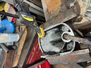

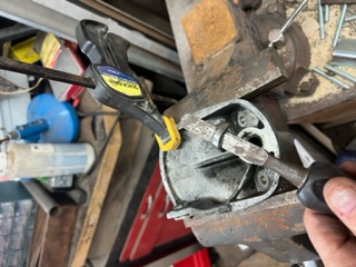

930cabman   How did you remove the small oil seal from it...   Jan 18 2023, 06:29 PM
Chaznaster   Maybe use a seal puller? Runs less risk of damagin...   Jan 18 2023, 07:57 PM
930cabman   Maybe use a seal puller? Runs less risk of damagi...   Jan 19 2023, 05:54 AM
r_towle   If it’s the rubber seal I think it is from the k...   Jan 18 2023, 08:51 PM
914werke   Maybe use a seal puller? Runs less risk of damagi...   Jan 18 2023, 10:09 PM
