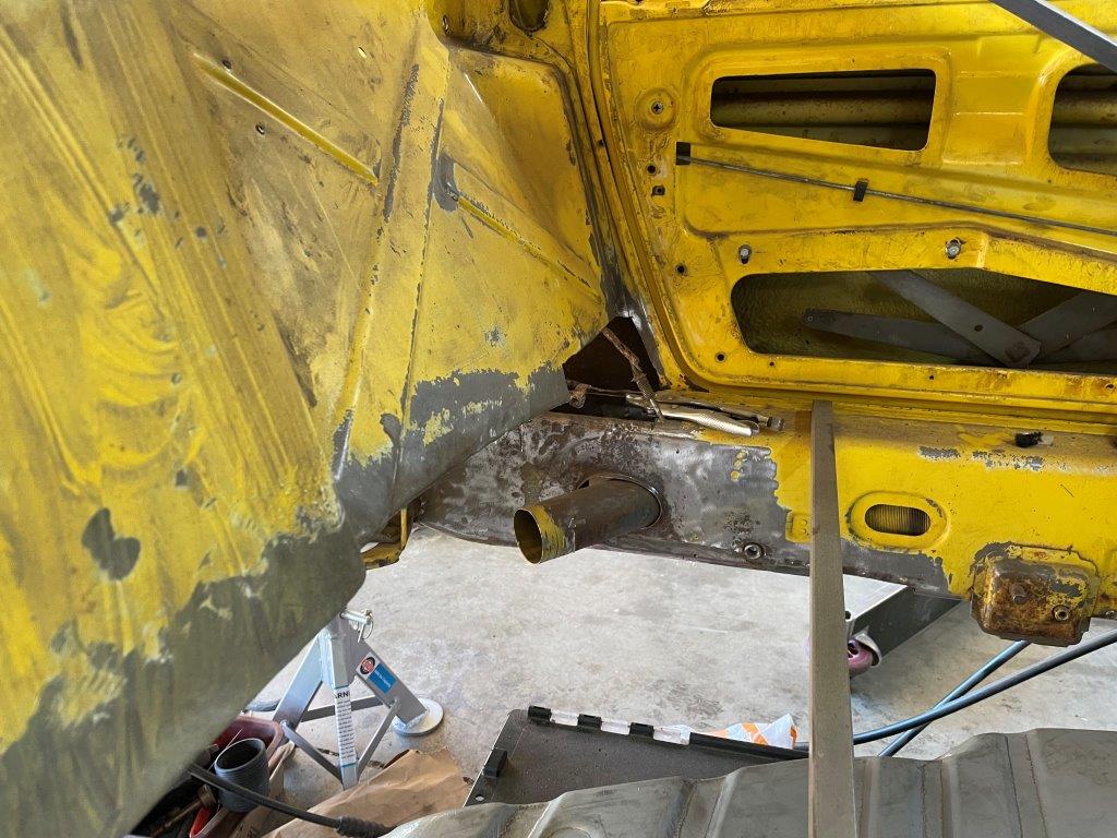

Some of this work happened a couple months back, especially within the area of the drivers side. Driver side was almost as bad as the passenger side!!!!
Also, deleted the entire lower fire wall. Thought it to be easier just to remove the lower section and weld in new.

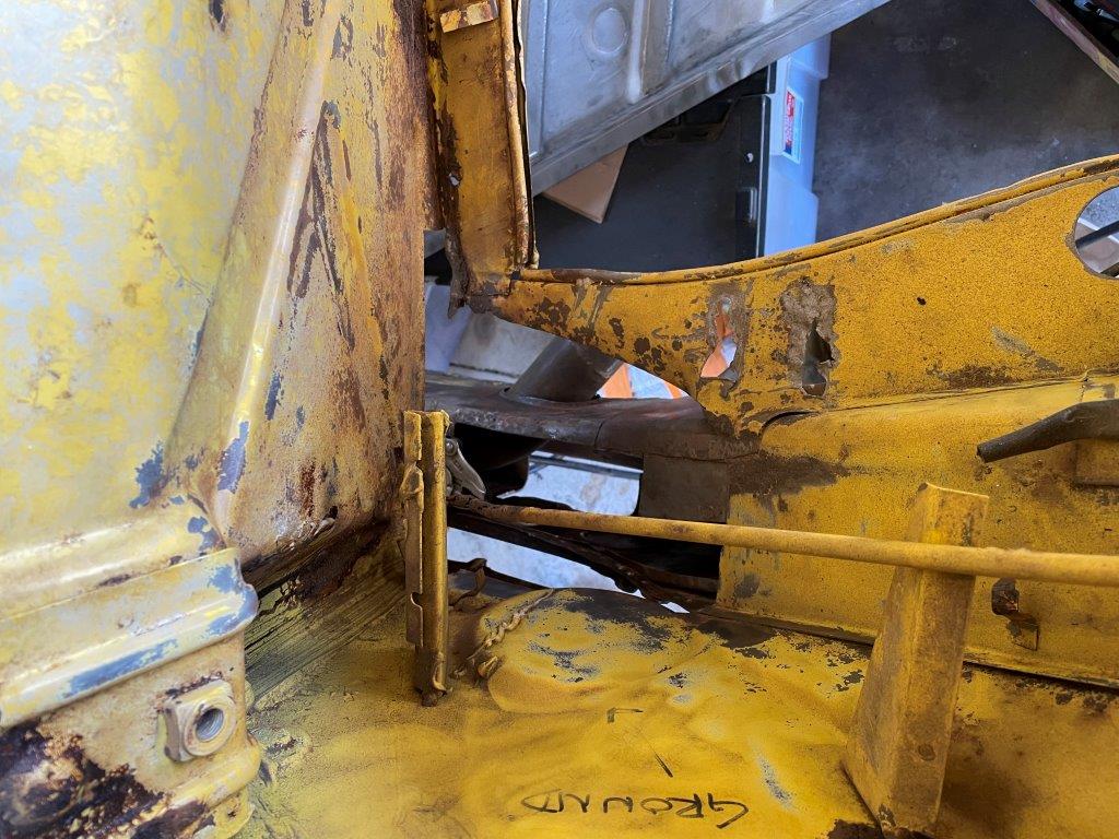

Looking down.

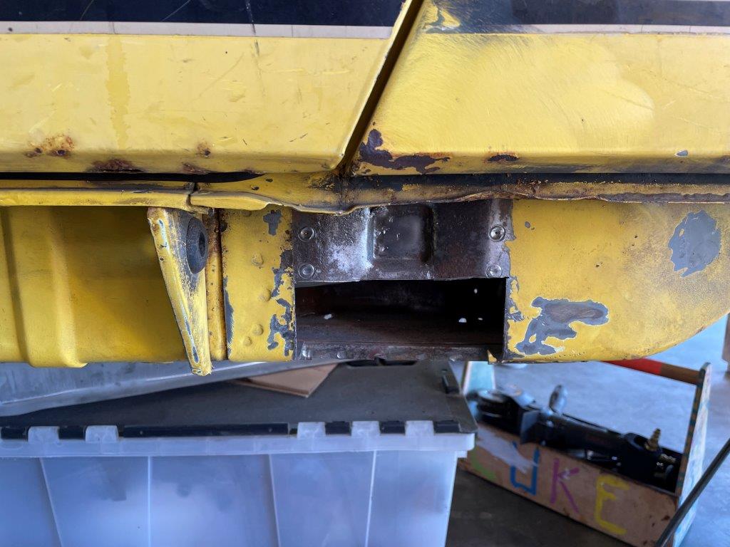

Outside jack post. Not too bad.

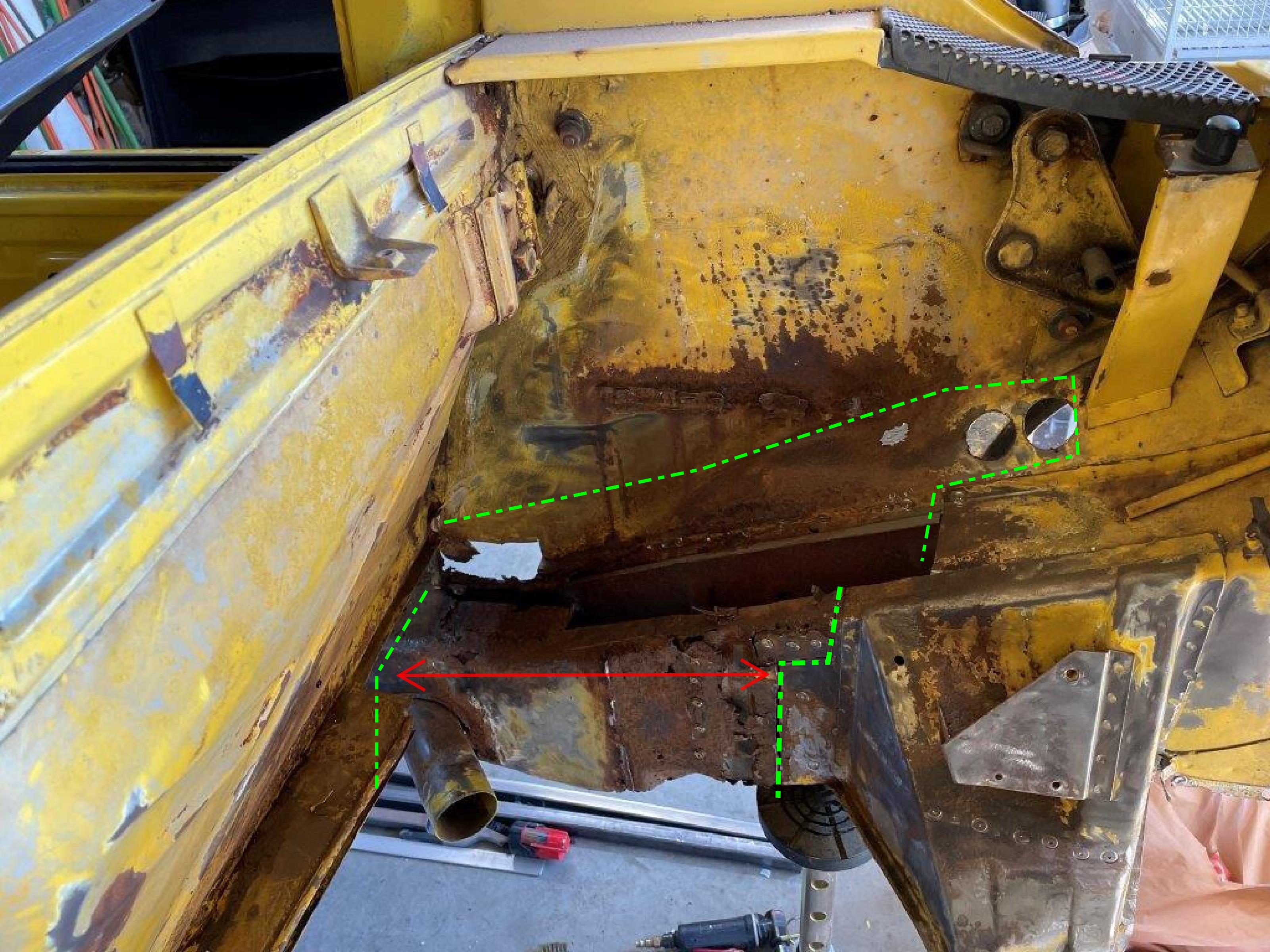

Passenger side. Trying not to remove the suspension console, most of the metal looks good behind too.
Going to remove everything between the green lines of the inner and outer.
Going to add a lower door brace as the car started to sag a bit once we started cutting out metal. Looks like it moved about a 1/16". My son said he heard a few cracks once he cut through the inner long. We do have it braced at the doors...just wondering if it will pull in once we start welding. I would prefer to get the measurements back into spec prior to welding though.
Looking at getting it onto a rotisserie, the RD version. Looks like I can fabricate one for about $300 and will make it a lot easier to get to the hard to reach locations.
But will a rotisserie really help with bracing at the longs when doing this work????

930cabman   The longs are double thickness, staggering your la...   Jan 23 2023, 03:34 PM
bkrantz   You might already know this, but acid-rusted metal...   Jan 23 2023, 08:37 PM
PlantMan   You might already know this, but acid-rusted meta...   Jan 24 2023, 09:42 PM
