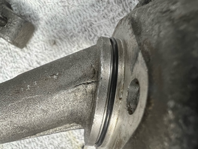

I have a side shifter that leaks at the console.
I cold drip every hour…
I bought the transmission gasket set from pelican
There is nothing in the set for the shifter console….nada
I removed the console
It looks like there is a bushing at the bottom.
Does anyone have a clue on part numbers to order to rebuild the shifter console?
It’s a 75/76 if that matters.
Rich
r_towle
post Jan 24 2023, 03:05 PM
Custom Member
Posts: 24,705
Joined: 9-January 03
From: Taxachusetts
Member No.: 124
measured the housing groove, its 2.25mm
measure the o-ring...its 1.25 mm
I just don't want this to leak again...

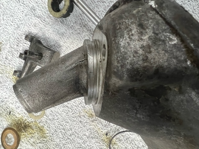

930cabman   Having the same issue and dis assembled it today. ...   Jan 14 2023, 06:09 PM

Dave_Darling   May? It will; it comes out as a unit. The rake h...   Jan 16 2023, 10:36 PM
r_towle   Btdt, no swearing required when in neutral. Got it...   Jan 16 2023, 10:54 PM
Dave_Darling   There's just the slightest possibility I was e...   Jan 17 2023, 05:06 PM
r_towle   There's just the slightest possibility I was ...   Jan 18 2023, 04:32 PM
930cabman   Yes, the shaft #13 with rake attached did come out...   Jan 17 2023, 05:34 PM
Dr Evil   Do not use the paper gasket under the console. Tha...   Jan 17 2023, 08:19 PM

r_towle   Very slight side to side wiggle… Not enough to c...   Jan 22 2023, 09:56 PM
930cabman   "Crushed and damaged" O ring would indic...   Jan 23 2023, 05:56 AM
r_towle   It was certainly leaking from the housing due to t...   Jan 23 2023, 03:09 PM
r_towle   Drove up to my local dealer. Pet2 lists the o-ring...   Jan 24 2023, 02:44 PM
r_towle   measured the housing groove, its 2.25mm measure th...   Jan 24 2023, 03:05 PM
930cabman   I was at my local bearing house today and picked u...   Jan 24 2023, 05:46 PM
