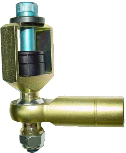

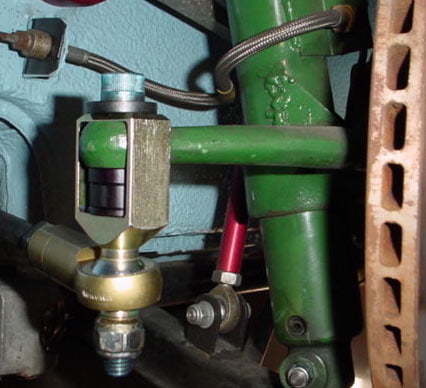

Yeah, those "bump steer" spacers are the worst way to "fix" bump steer since they completely throw off the steering geometry.
And as you already know, can cause binding upstream.
Instead of pushing the whole steering rack down, you can add drop-link spacers at the tie-rod ends.
(IMG:http://www.914world.com/bbs2/uploads_offsite/cdn6.pelicanparts.com-179-1674686766.1.jpg) (IMG:http://www.914world.com/bbs2/uploads_offsite/cdn6.pelicanparts.com-179-1674686825.1.jpg)
That solution looks like the best way to handle it. This is the problem with these old cars as too many previous owners and hard to tell what is right and what is wrong. Parts diagram helped me after much frustration. Thanks for the help!
