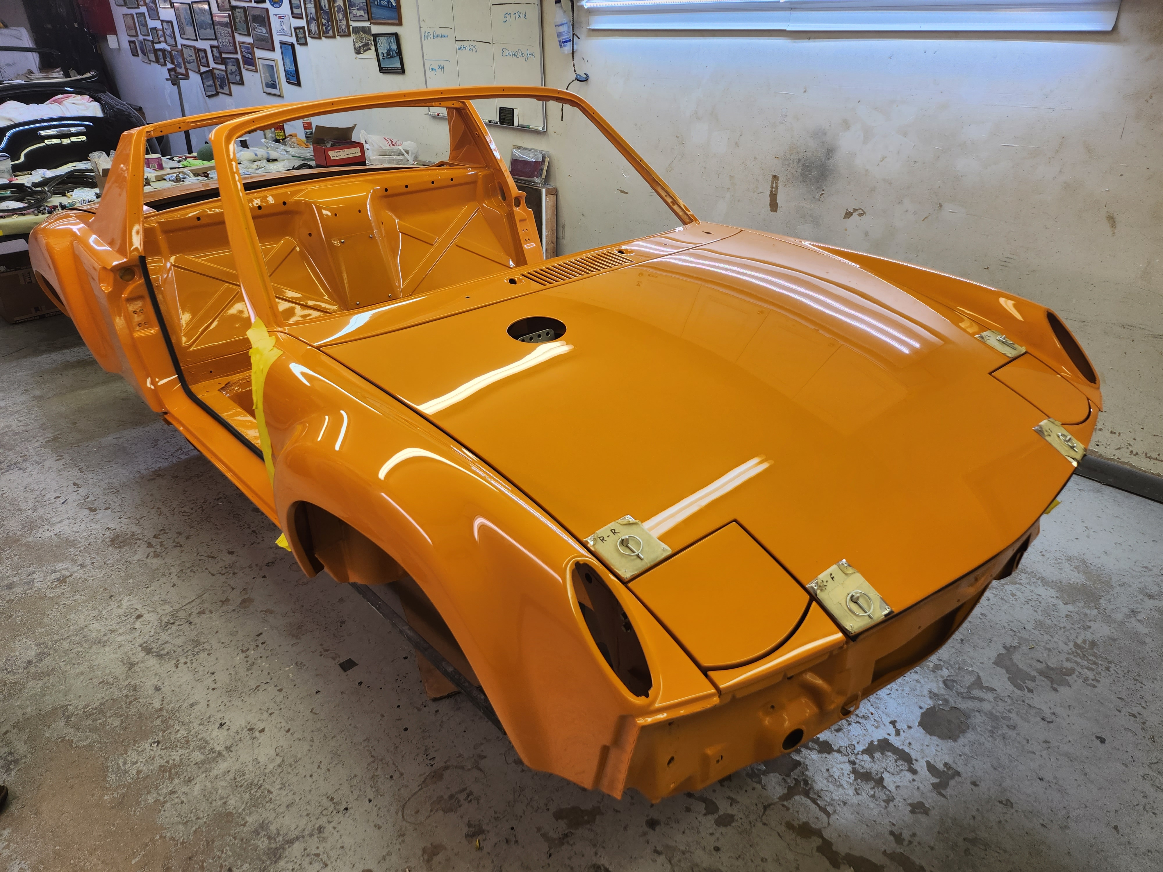

Bullethead
post Jan 26 2023, 04:24 PM
Oil Cooled heart
Posts: 970
Joined: 24-June 10
From: South Florida
Member No.: 11,875
QUOTE(Krieger @ Dec 30 2022, 11:26 AM) *
WOW, that looks amazing! Don't rush the reassembly.
Of course, you're right. Steady progress... lids and doors fitted, headlight actuator works great, soon back to Klubsport for the drivetrain.
Still waiting for some parts from Germany, but finally got good news that the brightwork is on the way, and all of the rubber has been accounted for. Time to polish some glass.
