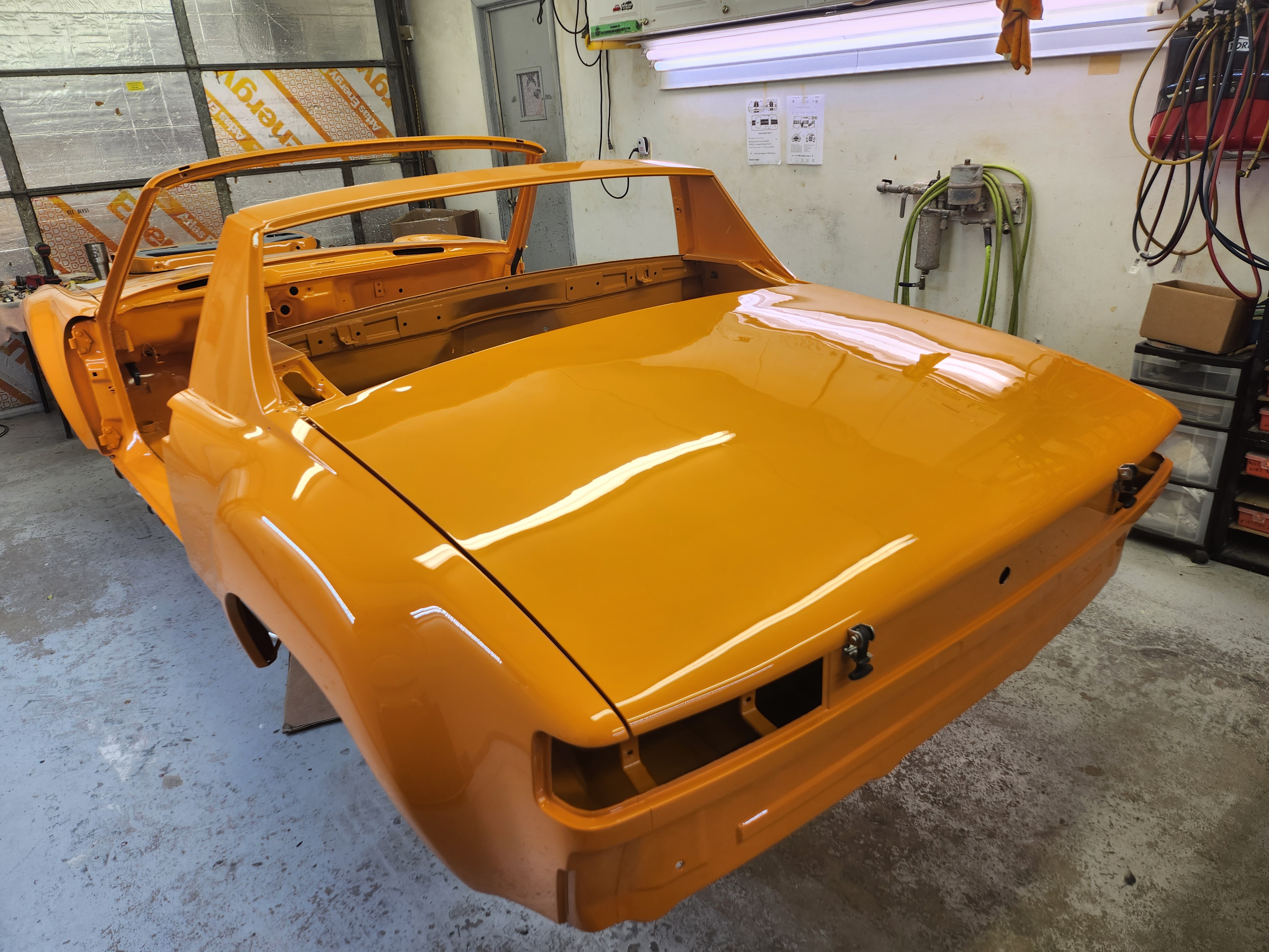

Panel fit and paint is near perfection... these guys do exceptional work.
