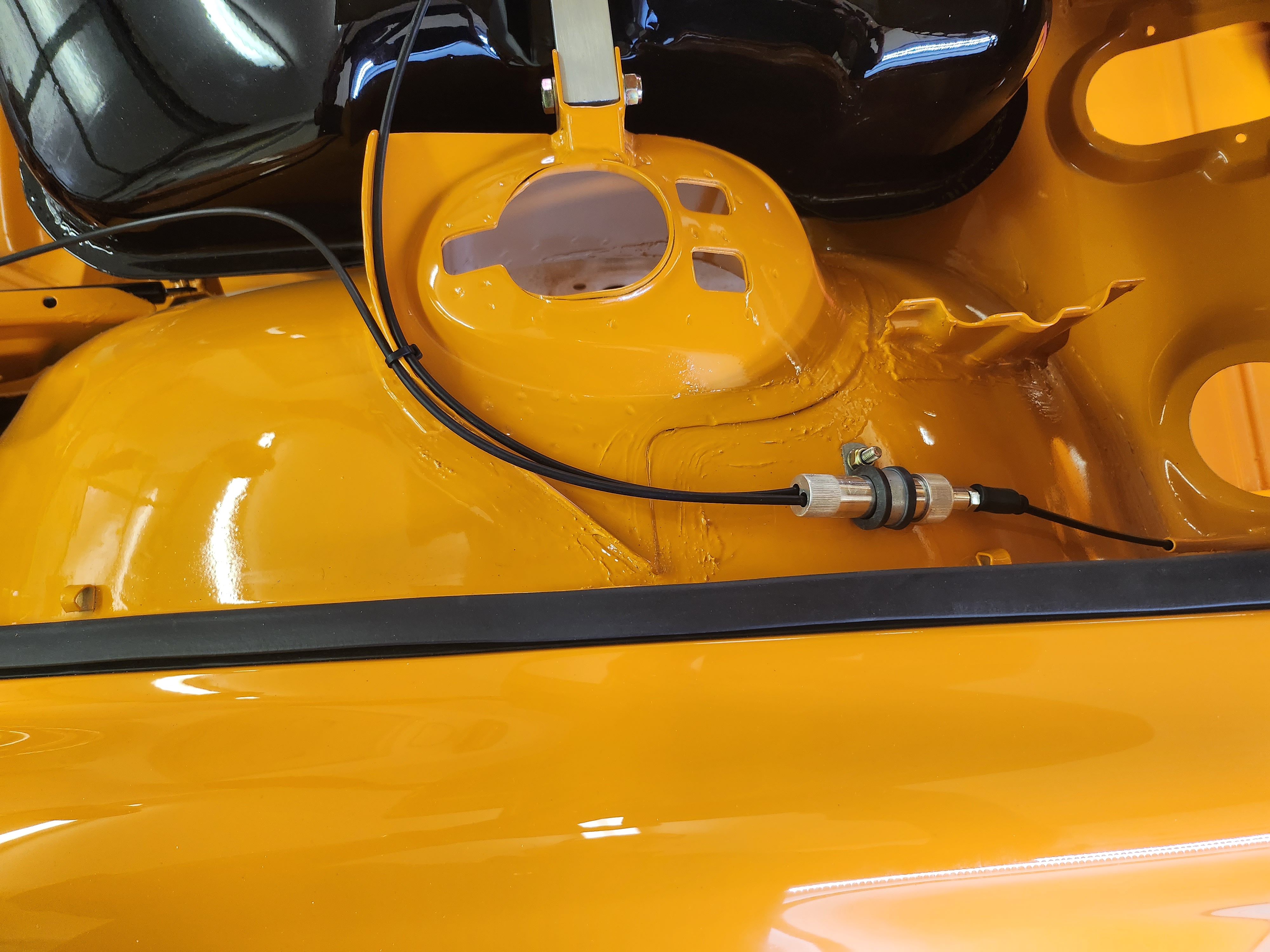

mepstein   On the kit I saw, the cables were bicycle cables a...   Apr 1 2022, 01:10 PM
TRS63   It keeps getting better :wub: Antoine   Apr 1 2022, 01:16 PM
Bullethead   Thanks Antoine... to answer an earlier question, I...   Apr 1 2022, 01:27 PM
live free & drive   Your roll bar looks way too short - too close to t...   Apr 1 2022, 02:07 PM
mepstein   Check the end of a derailleur cable.   Apr 1 2022, 04:48 PM
Bullethead   Check the end of a derailleur cable. :trophy: ...   Apr 1 2022, 05:01 PM

IronHillRestorations   Try Comet Kart Sales for cables   Apr 4 2022, 08:27 PM
Bullethead   Try Comet Kart Sales for cables Thanks but same...   Apr 4 2022, 09:48 PM
mepstein   We used to have to smooth out the ends sometimes i...   Apr 4 2022, 10:13 PM

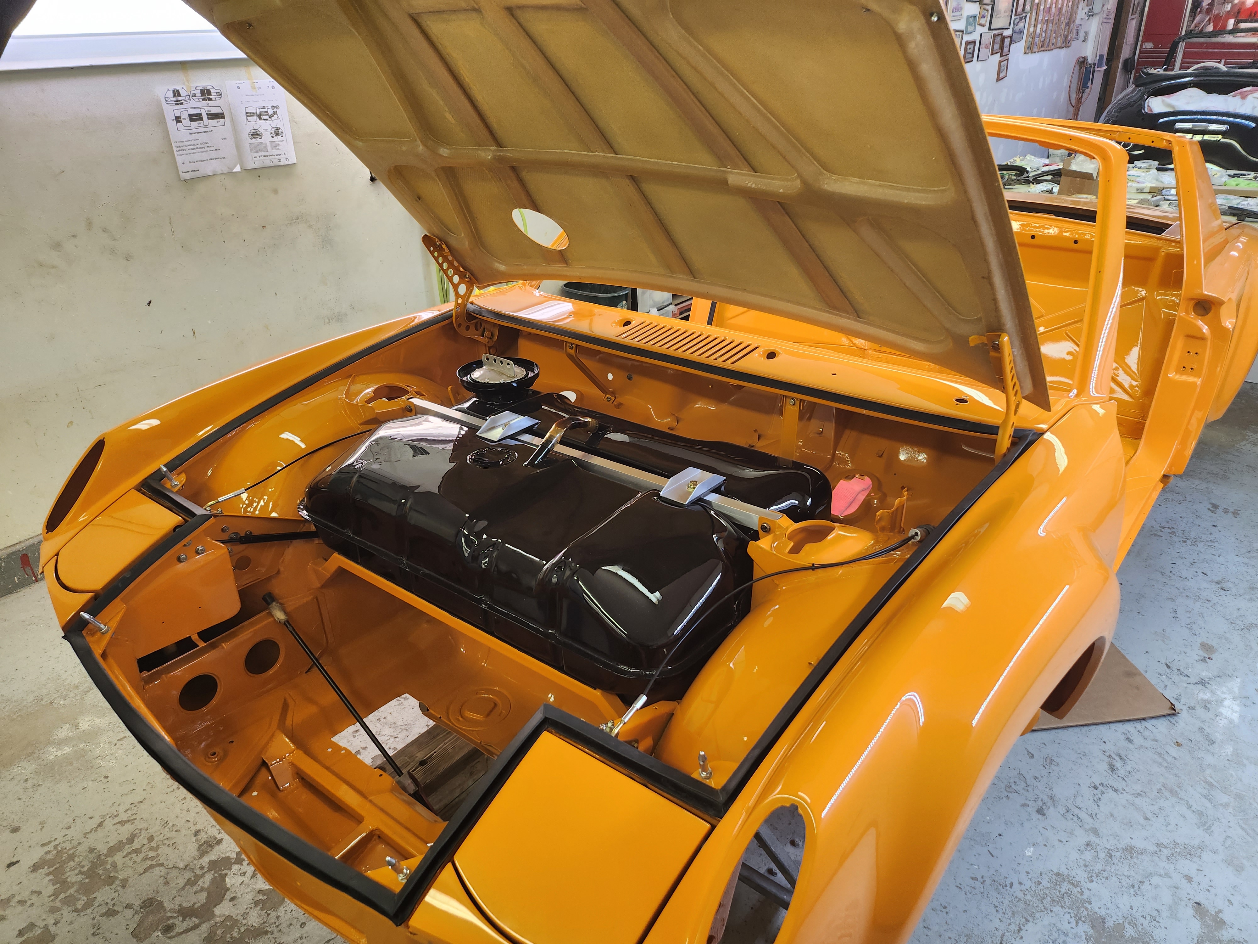

Bullethead   RE: 1970 914/6 GT Replica Build   Jun 12 2023, 02:15 PM
Bullethead   Not digging the fresh air / defrost job at all. I ...   Jun 12 2023, 02:22 PM
