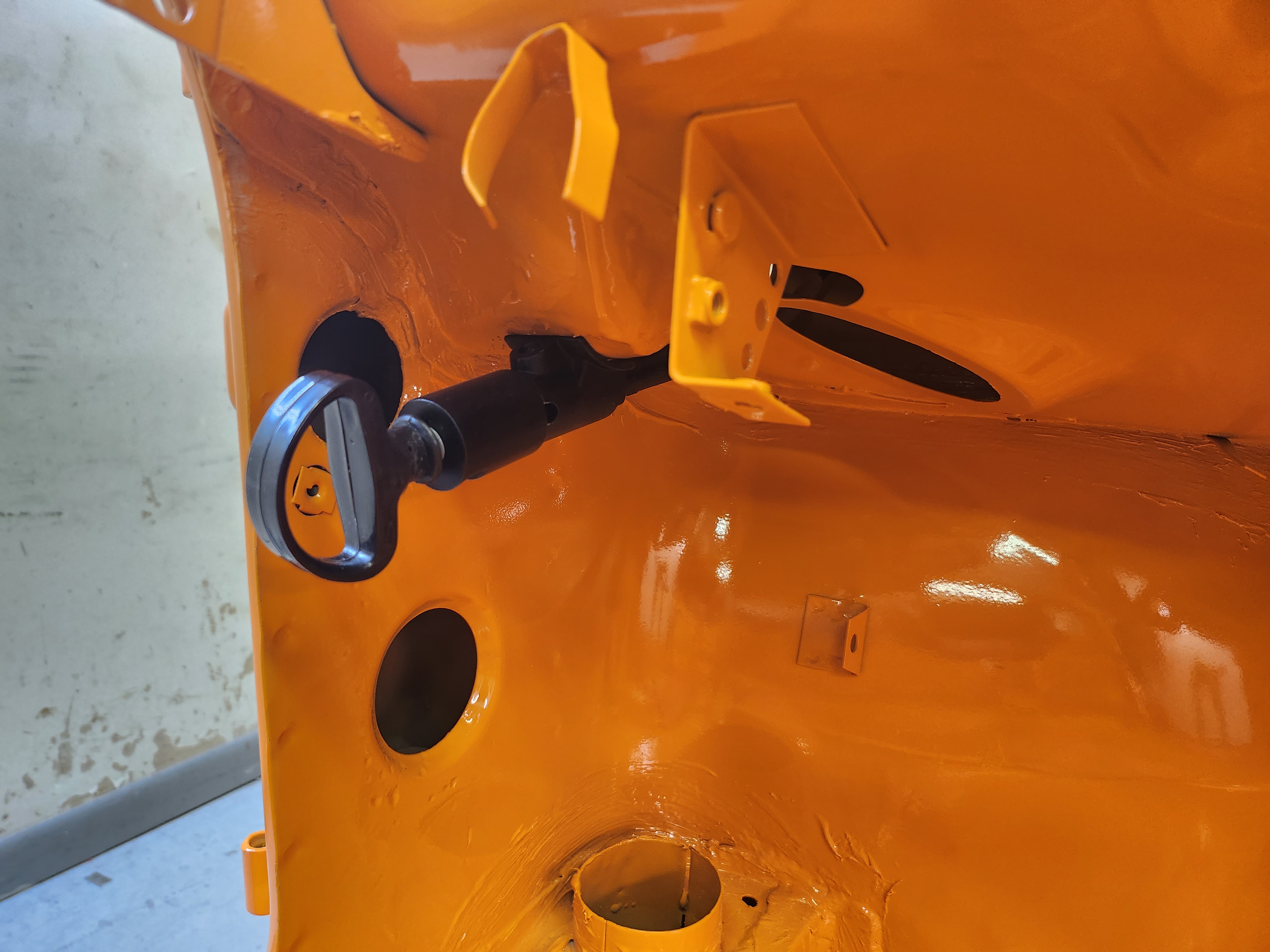

Used the same "D" handle for the lights as for the engine lid. Cheap and easier than adapting the hood release part.
