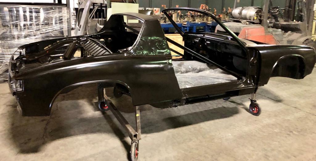

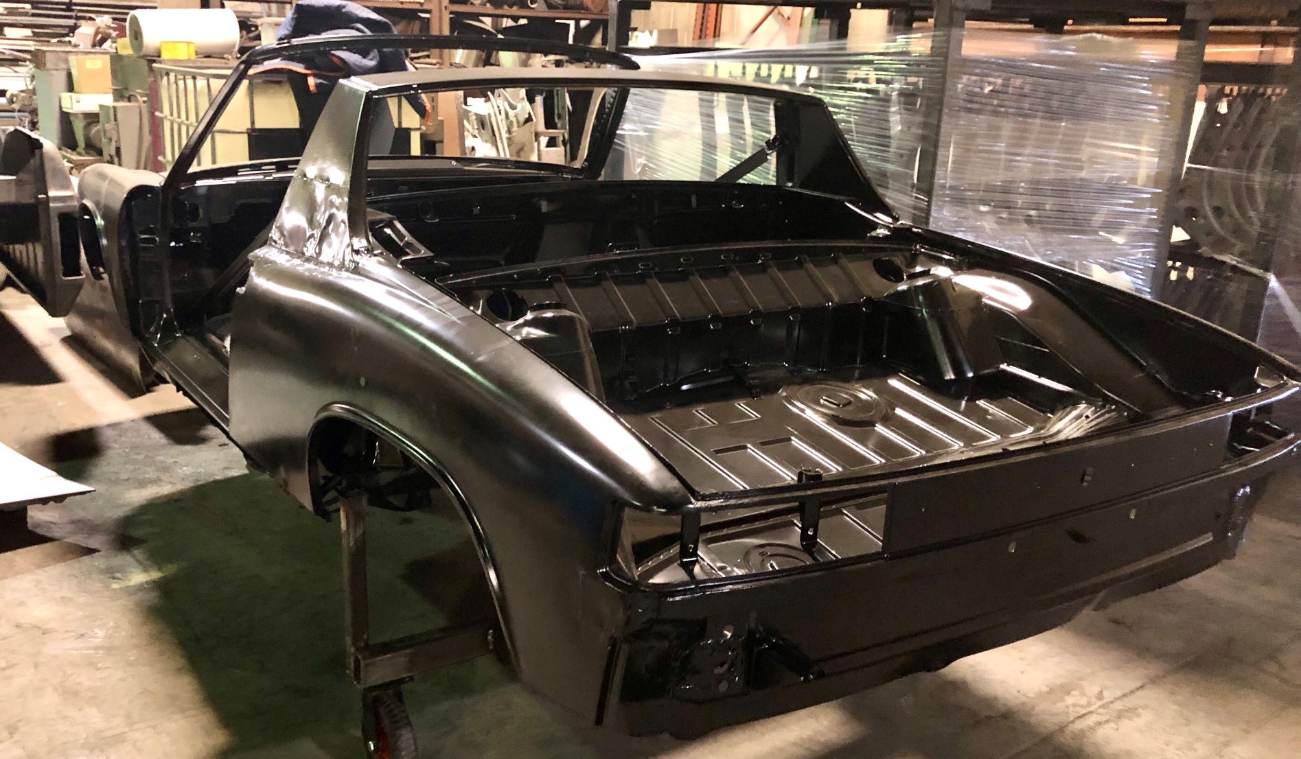

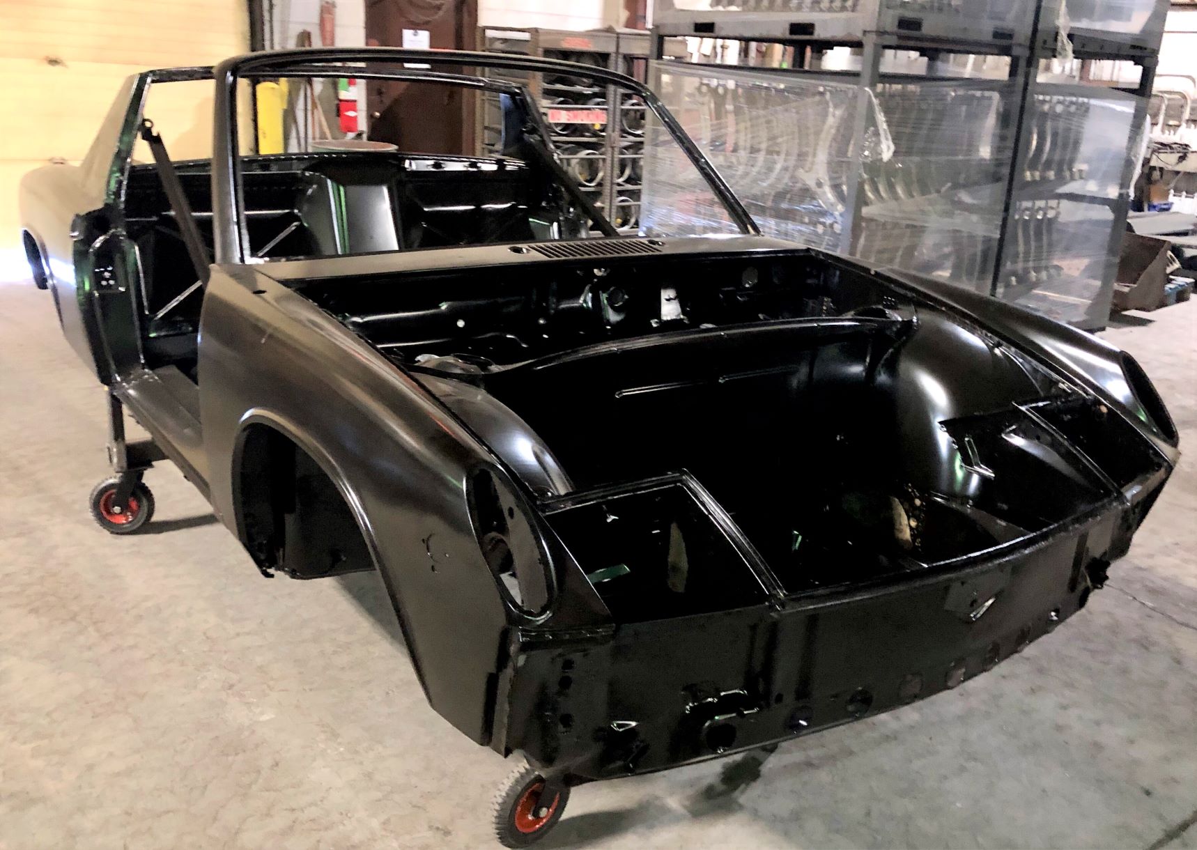

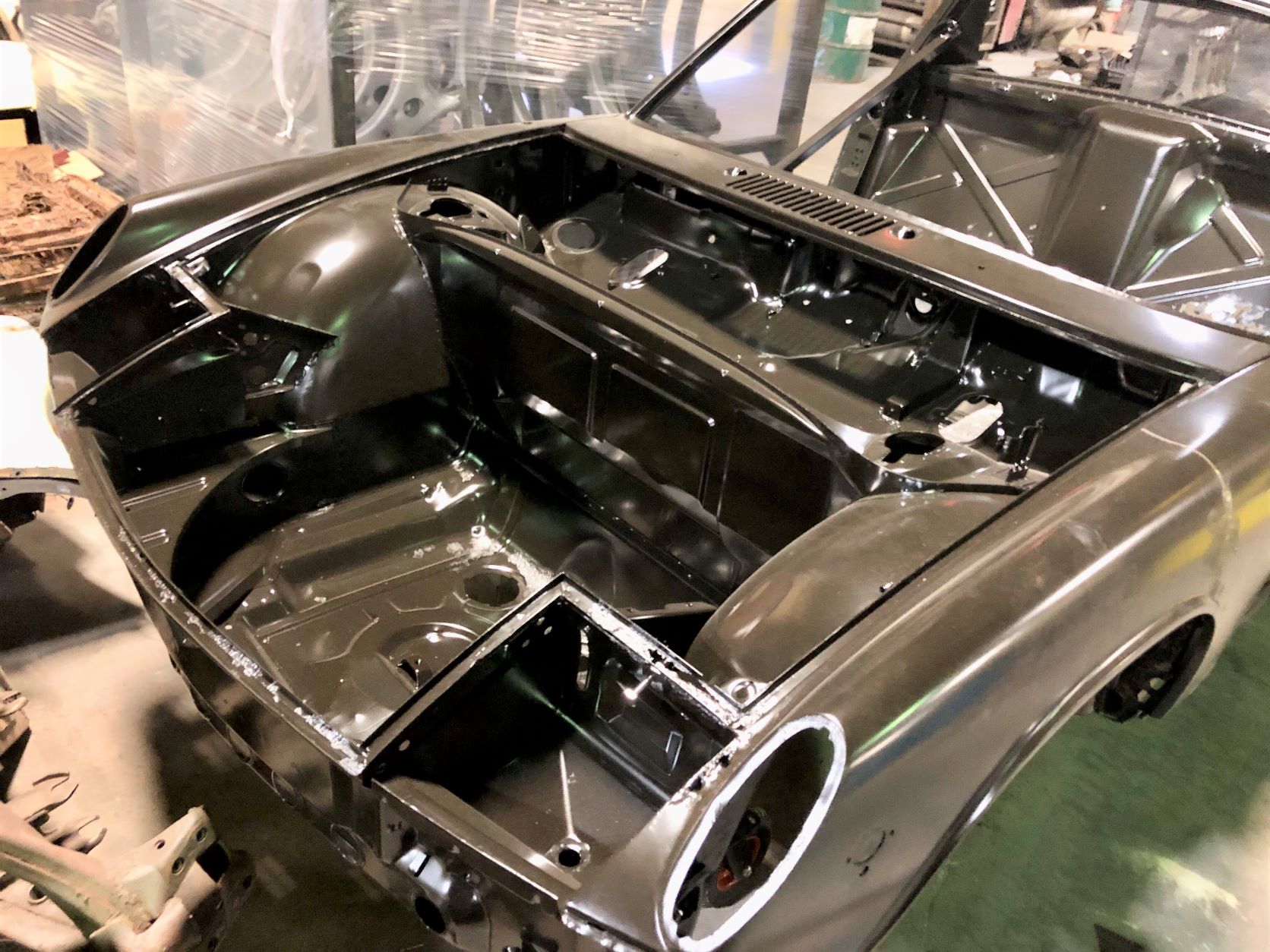

Tom1394racing   The chassis has now completed the dipping/E-coat p...   Jan 27 2023, 01:39 PM

Tom1394racing   Mine is back home as well. I am pretty happy with ...   Feb 28 2023, 03:40 PM
