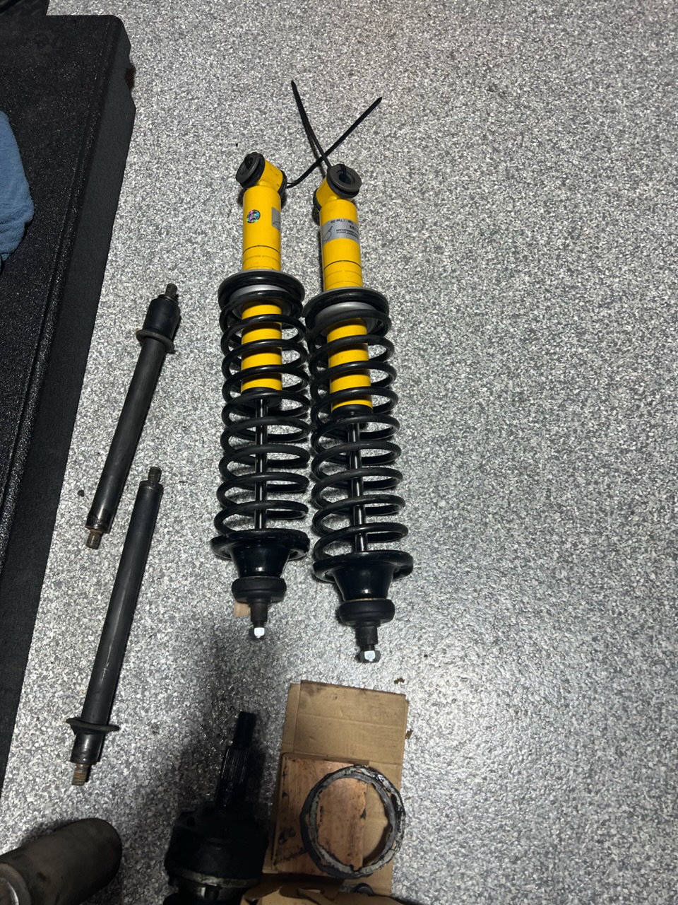

Rear bushings, struts, and exhaust all on. Just need to bleed the brakes and adjust the shifter before I finish the first stage of the build.

QUOTE(Motosan @ Jan 27 2023, 11:12 PM) *
Can I ask if the rear springs are the original ones, and in which ring clips did you fit the height on the bilsteins please.

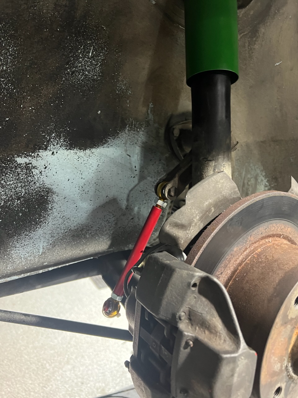

Motosan   Torsion bars were very stuck but turbo tie rods...   Jan 21 2023, 10:17 PM
Motosan   Front end almost done, rear end started, and a ver...   Jan 25 2023, 11:16 PM
