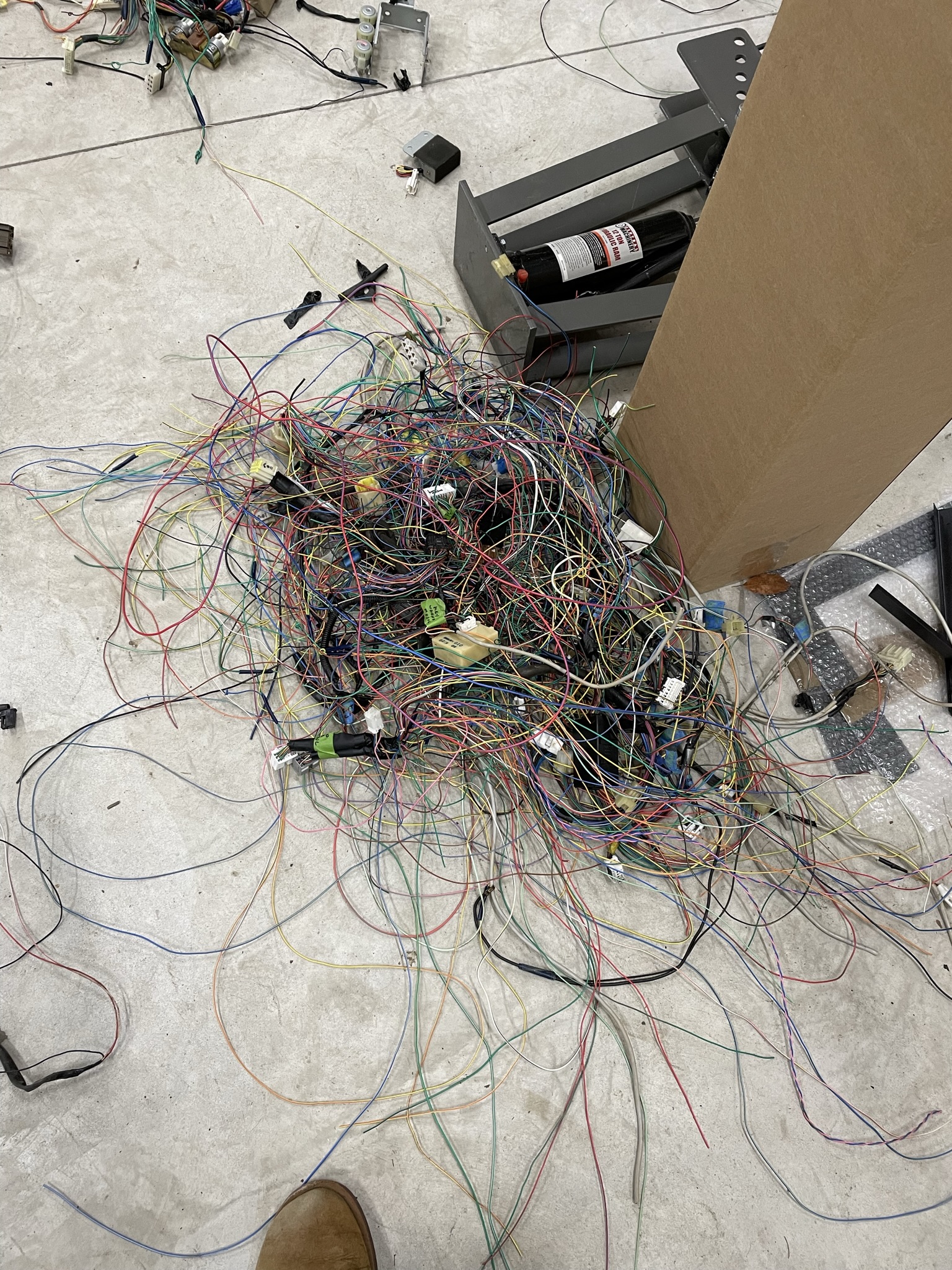

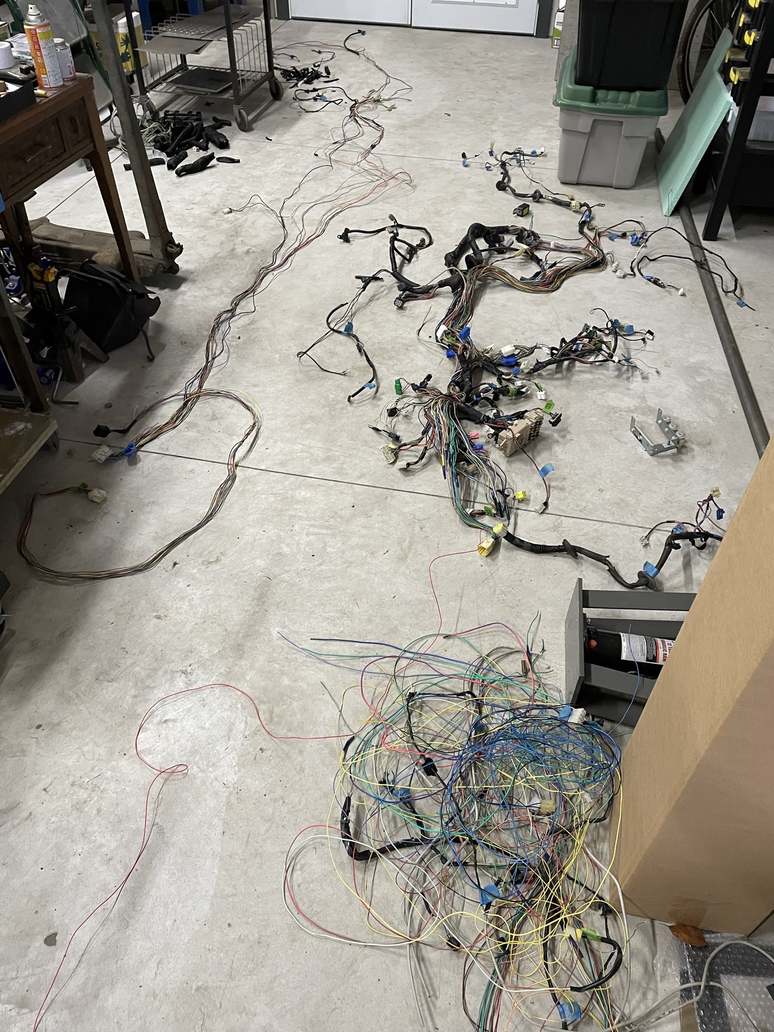

Surfing through a sea of wires………I plan to use the entire wiring harness from my donor Subaru. I’ve been paring it down to what’s needed in the 914. The large pile of wires is what’s been removed so far.
