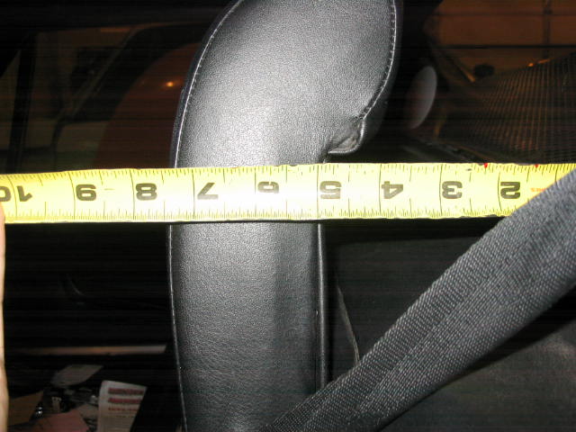

Just got back into town from a 3 hr white knuckle ride up I35. Here's the photo of the head rest. I moved the transaxle back 1.5" I don't know how much more you can move it before the axles are compermised. I removed everything off the front of the motor I could. I have one pulley on the balancer. You can't remove the cam gears. They are the furthest point forward.
