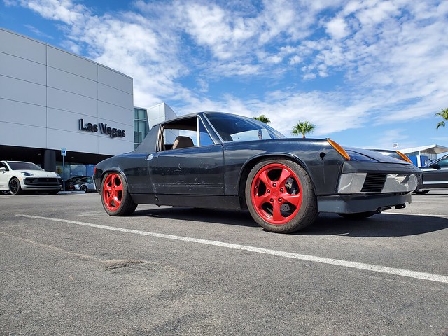

What kind of fool would want to do that?? (IMG:style_emoticons/default/av-943.gif)
All studs are 944 rear. I'll have to look at what spacers I ended up with. 15mm and 21mm I think. 225/45-17 (IMG:http://www.914world.com/bbs2/uploads_offsite/live.staticflickr.com-431-1659214723.1.jpg) |
