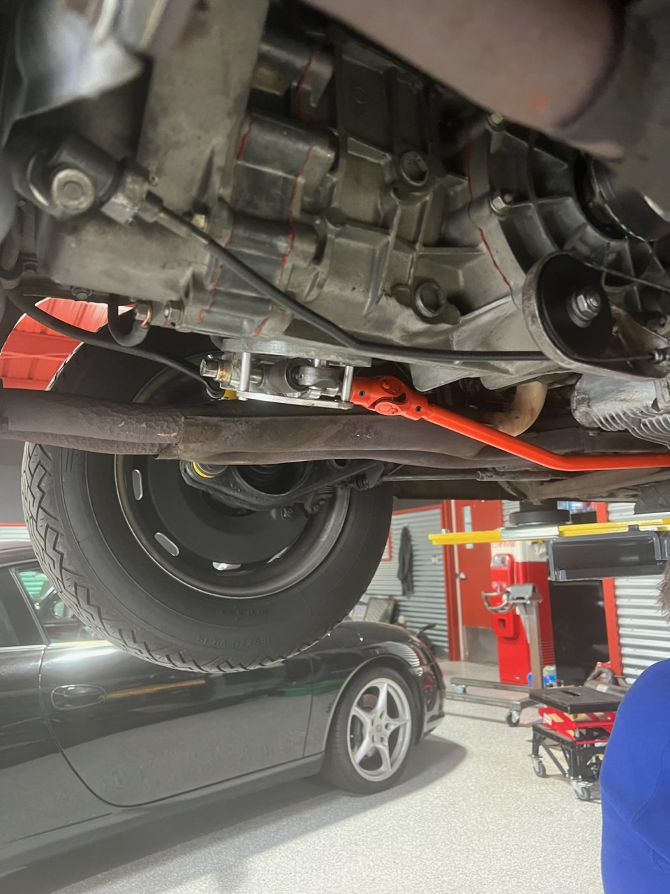

Motosan   Finally getting some work done. Trans is rebuilt a...   Jan 18 2023, 12:04 PM

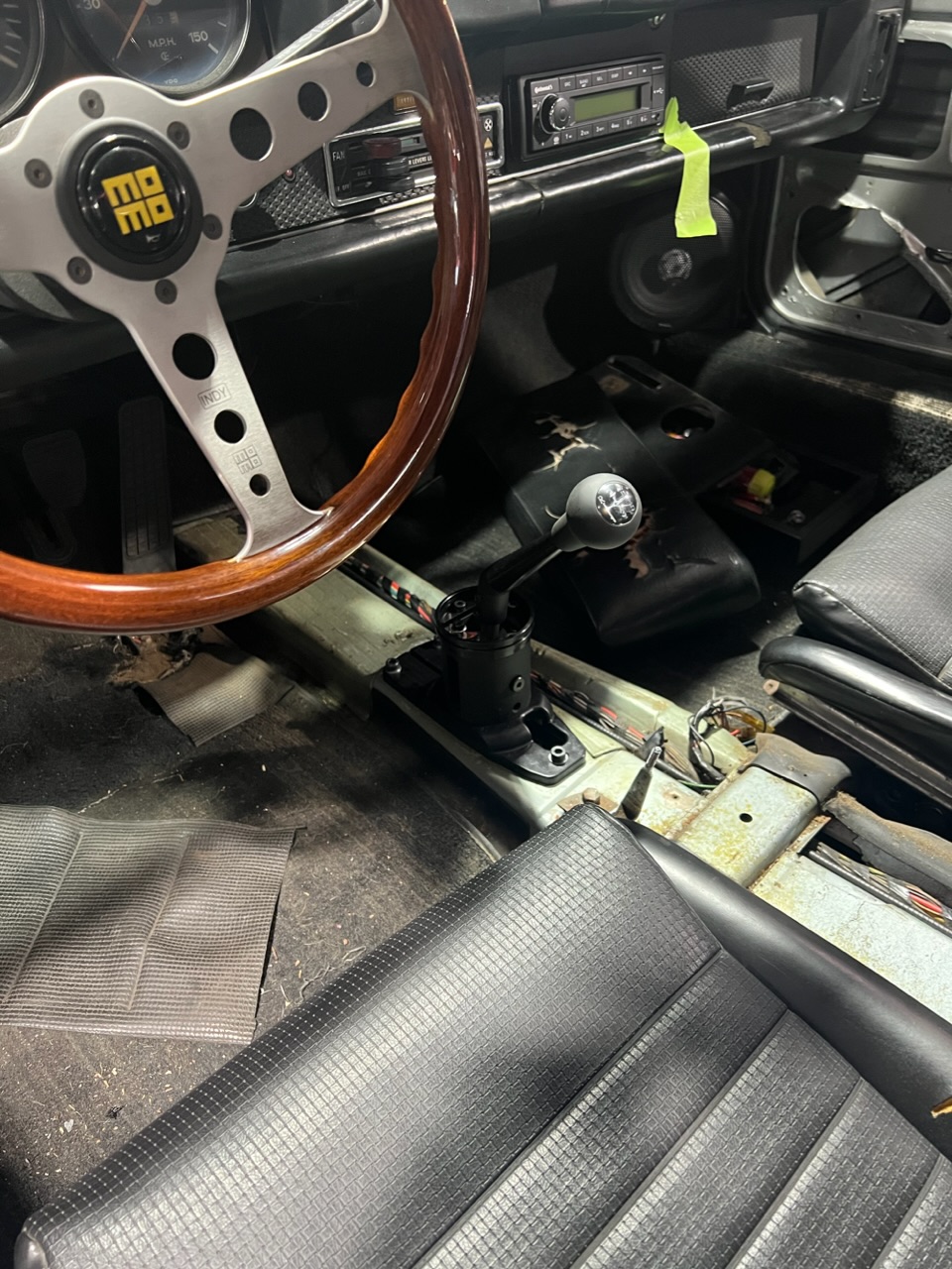

Motosan   Have the center console out for the shifter instal...   Jan 18 2023, 11:37 PM
