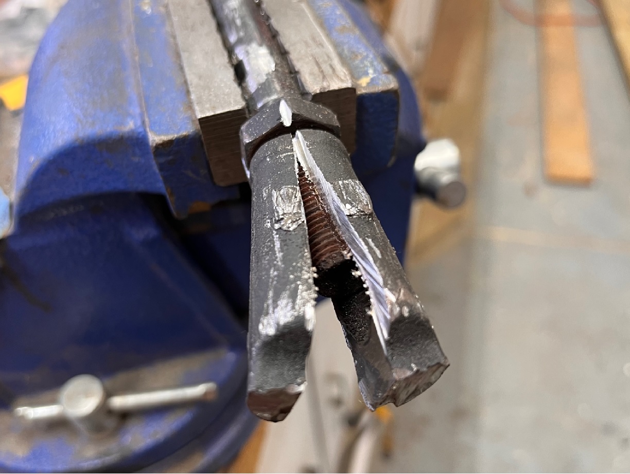

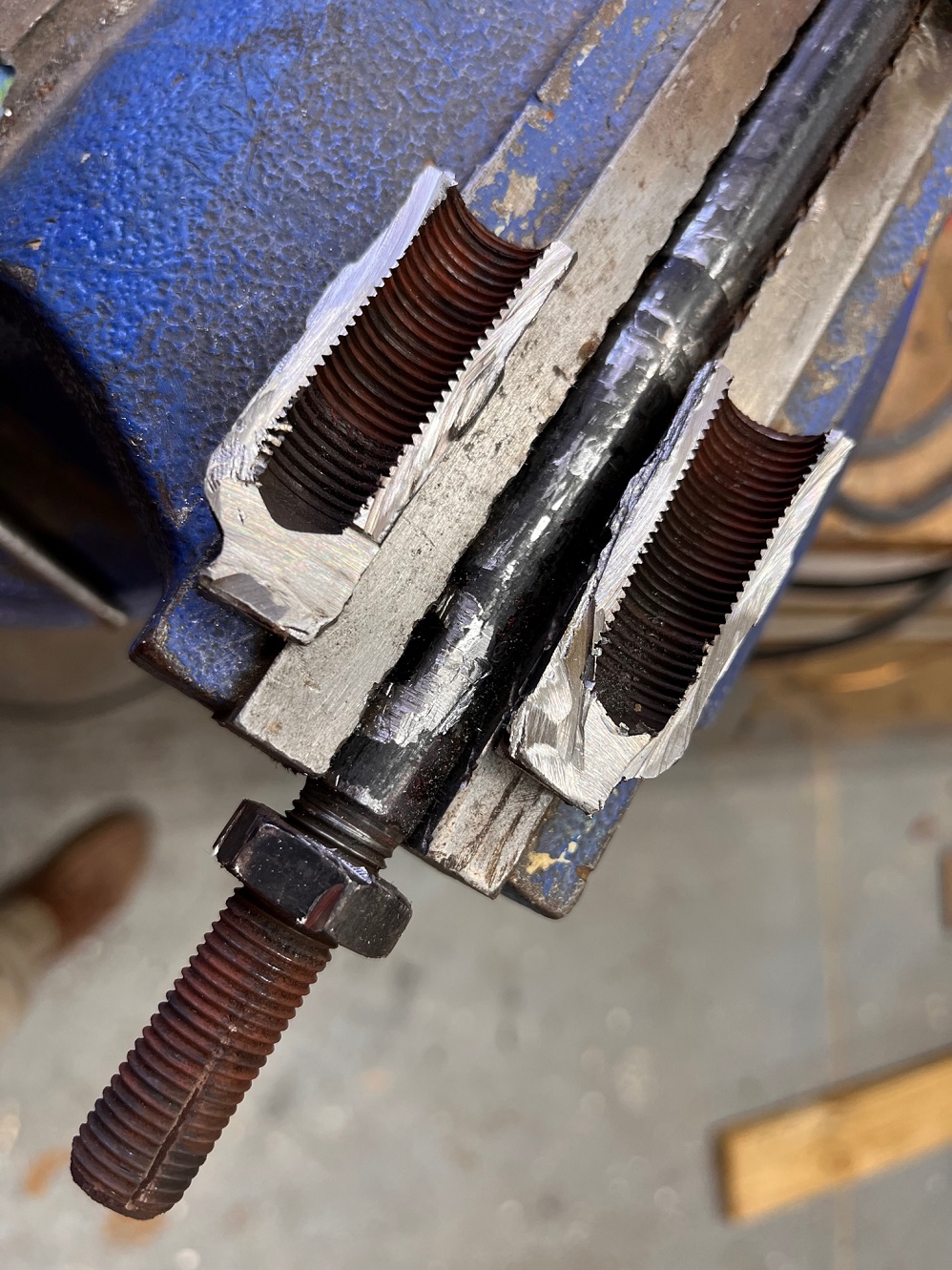

For those that are interested, I "unzipped" the threaded section of the old tie rod end to get it off the rod. Even with one side cut and banging with chisel and hammer it wouldn't come off. I had to slice both sides before it would give way. I don't see any obvious issues in the threads, so I'm still confused as to why it was so badly frozen on there.
