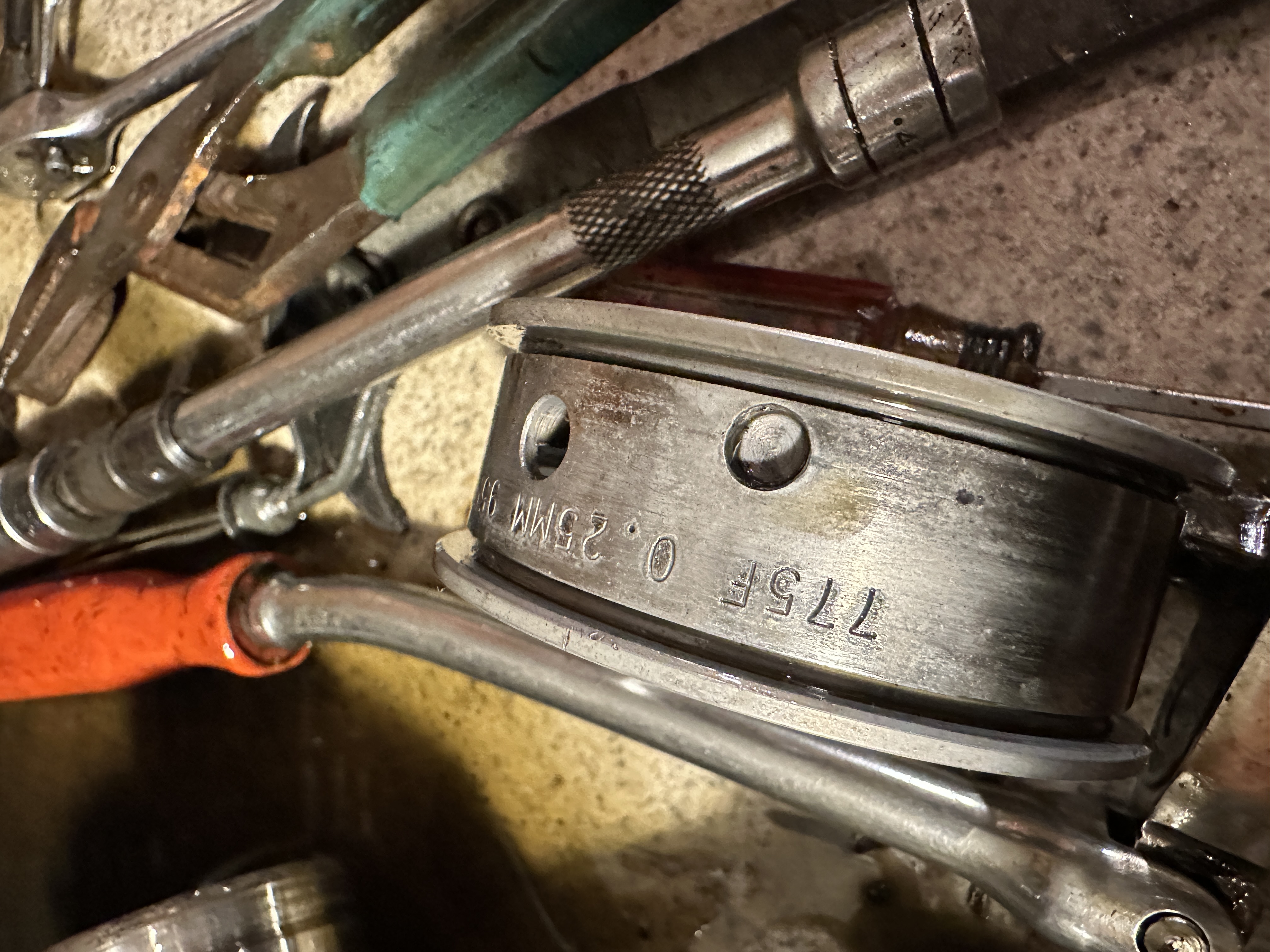

rear thrust againAttached Image

rfinegan   It took a while but I finally got a set of NOS KS/...   Mar 27 2023, 05:24 AM
rfinegan   Thanks to the generosity of a Kerry, world member...   Mar 27 2023, 05:29 AM
