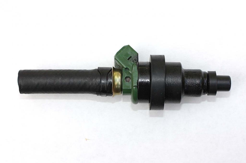

You can do that. I just decided to use the stock rails and securing hardware using these injectors...they should look familiar...
https://www.fiveomotorsport.com/high-impeda...jaguar-porsche/
I replaced the straight lines with curved ones from 914Rubber (or was it Pelican? I forget).
