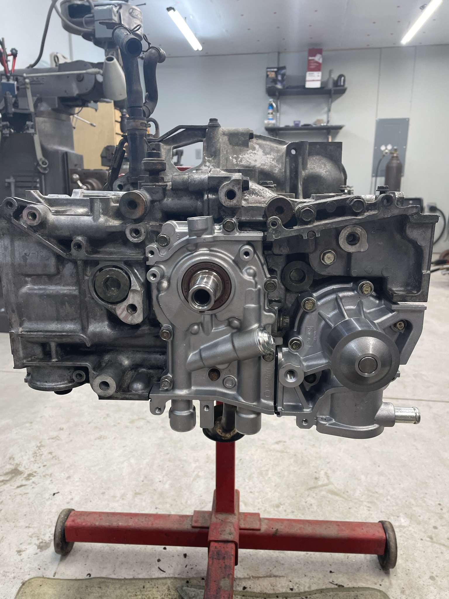

I tore down my donor Suby engine and replaced head gaskets, oil pump, water pump, and timing belt. I also installed an aluminum oil pan for additional clearance. I’ll be working on flipping my intake manifold shortly.

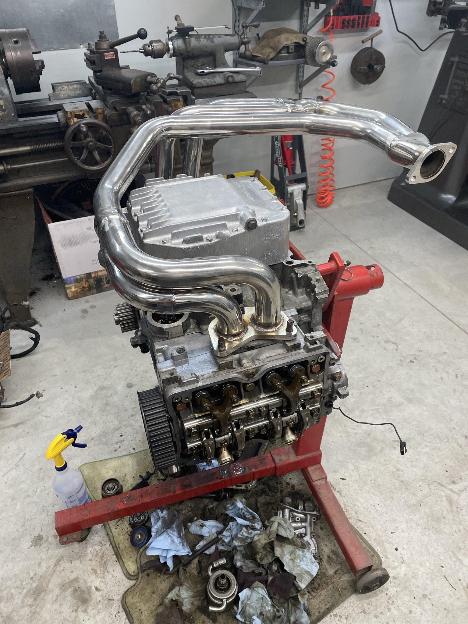

East coaster   I tore down my donor Suby engine and replaced head...   Feb 7 2023, 07:08 PM
East coaster   While the engine was upside down, I started fabric...   Feb 7 2023, 07:14 PM
raynekat   Nice welds there...you've definitely got...   Feb 19 2023, 11:20 PM
East coaster   Nice welds there...you've definitely got som...   Feb 20 2023, 07:01 PM
East coaster   Couple more pics….   Feb 7 2023, 07:15 PM
