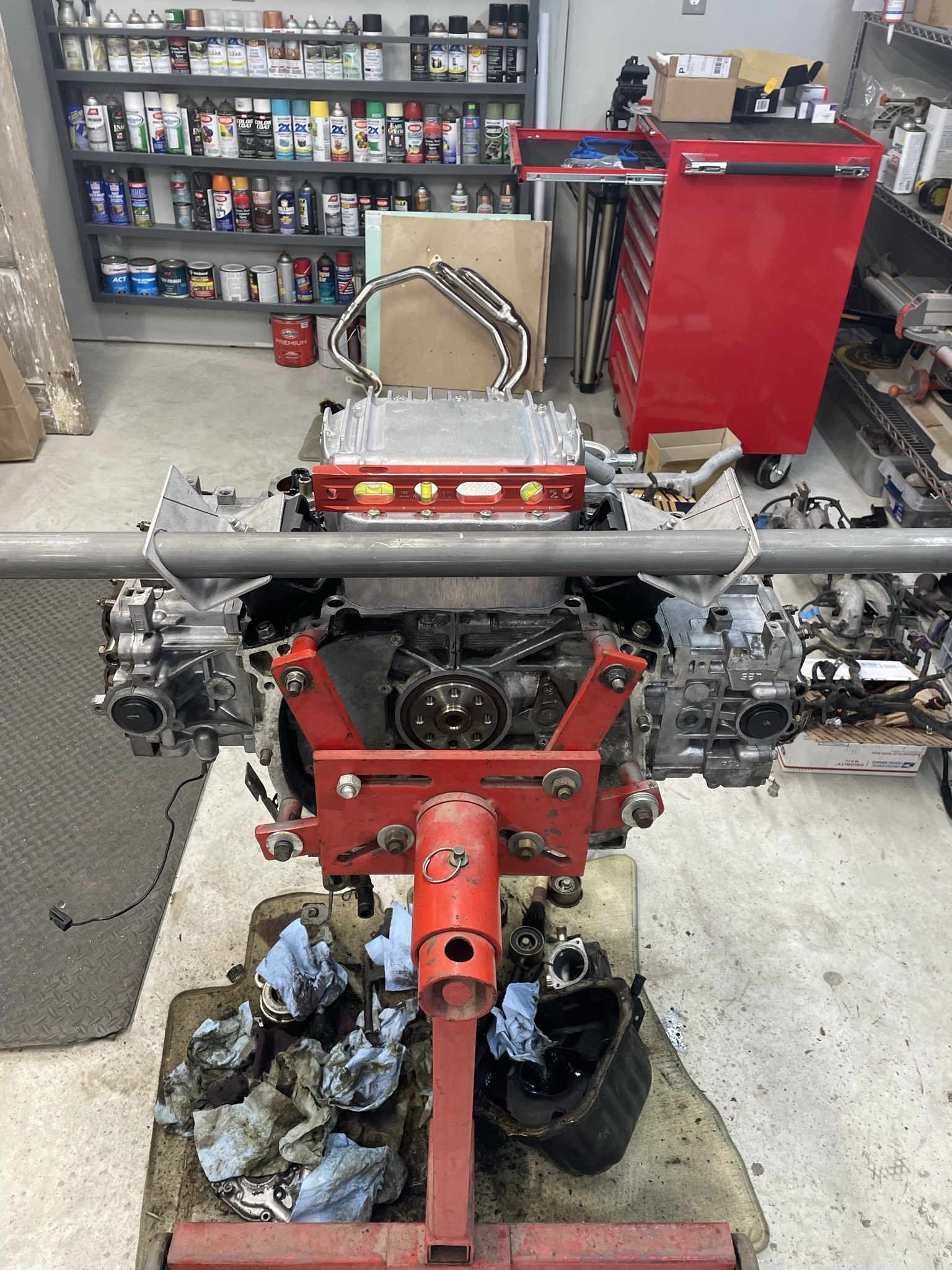

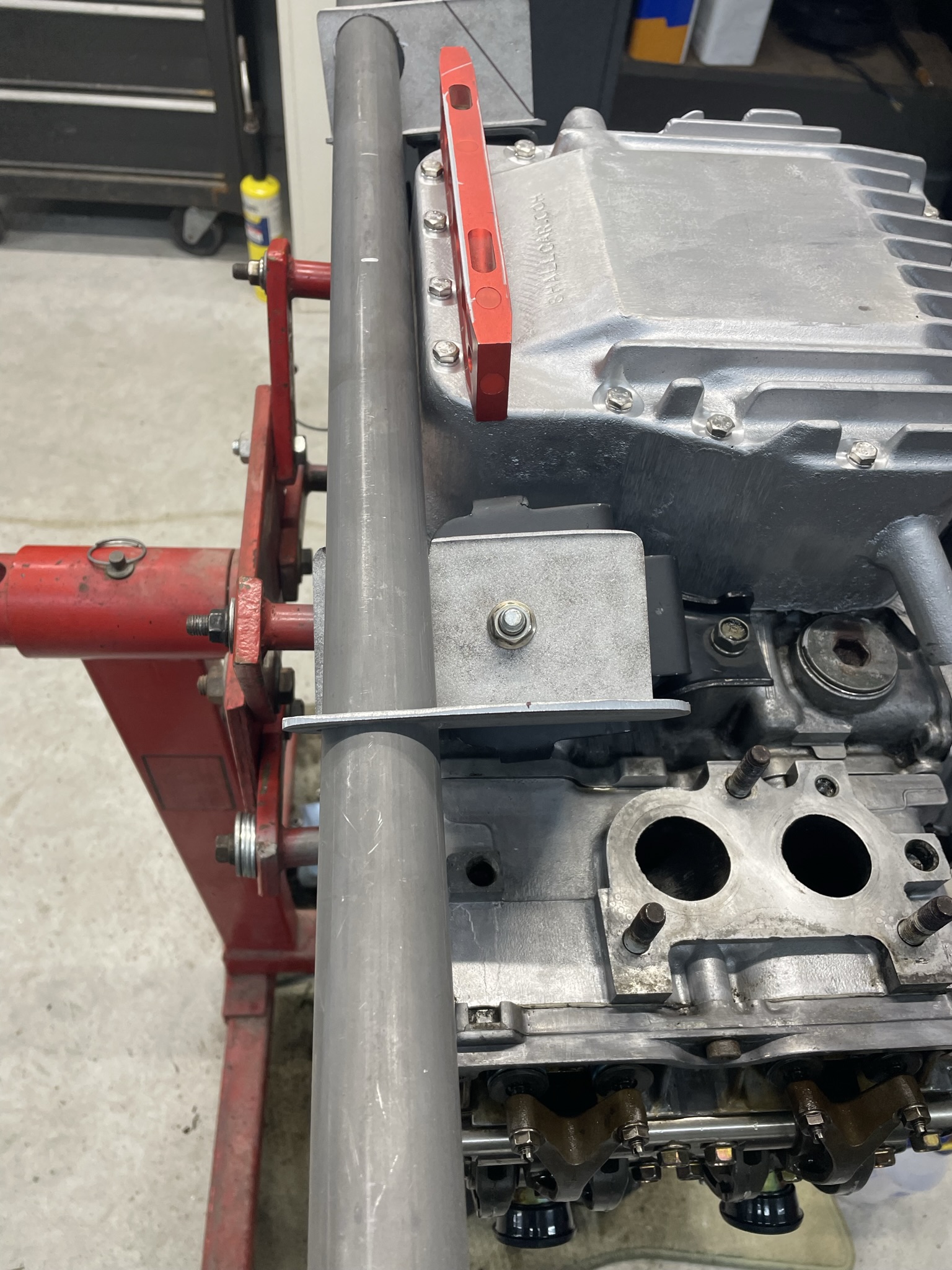

East coaster   I tore down my donor Suby engine and replaced head...   Feb 7 2023, 07:08 PM
East coaster   While the engine was upside down, I started fabric...   Feb 7 2023, 07:14 PM
