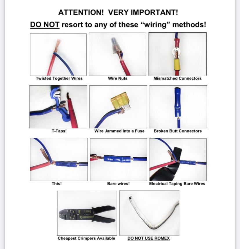

Was reading the Holly quick start guide. This guide also applies to 914 wiring and should be should be pinned. (IMG:style_emoticons/default/av-943.gif)
If you feel any of these are appropriate wiring - EFI is not for you (IMG:style_emoticons/default/happy11.gif)
