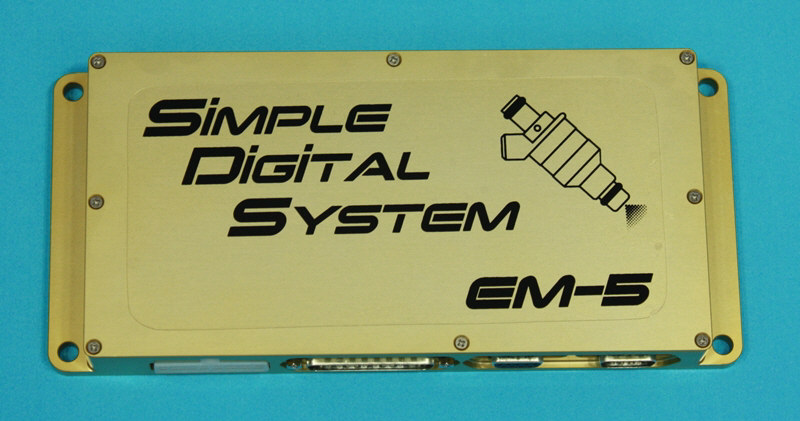

Has anybody looked at Simple Digital Systems for aftermarket EFI?
http://www.sdsefi.com/specific.html
The kit does not include:
Fuel injectors
Fuel pressure regulator
Fuel rail
Fuel pump
Fuel return line from regulator to fuel tank
Throttle body
George
