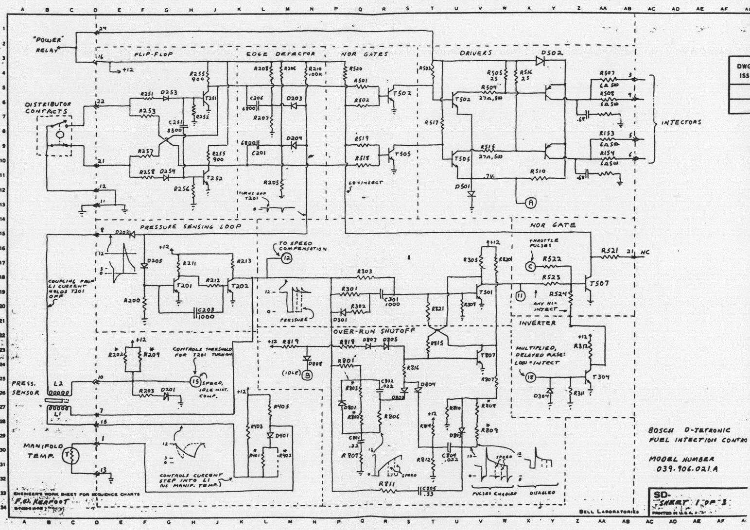

Let's say you already have a 123 distributor with the FI points that you are happy with - could you use one or both of the triggers as a cam/crank position sensor with Microsquirt?
I don't know a lot of about the 123 or how the factory system triggers the injectors...however, WAG'ing it from the stock DJet computer diagram, I think not.
If I'm reading that diagram correctly, the disty simply provides a "fire now" signal to one of two banks (stock DJet is batch injection) with no logic. Disty triggers open or close like points (or is it Hall Effect?), computer does some electrical magic, and the injectors fire.
Microsquirt (all pretty much all EFI), on the other hand, wants to know where the crankshaft is relative to TDC and from that, and your desired tuning, it calculates timing and fires the injectors; DJet triggers can't provide that, they're a binary signal.
Doesn't mean you can't continue to use the 123 disty and ignition coil if you want to, they'll run fine. But once the MS is installed it's only a few more components to remove the disty (and sell it) and put an EFI-driven coil on it. An EFI-driven coil also which allows you to vary timing based on RPM and load. - GA
