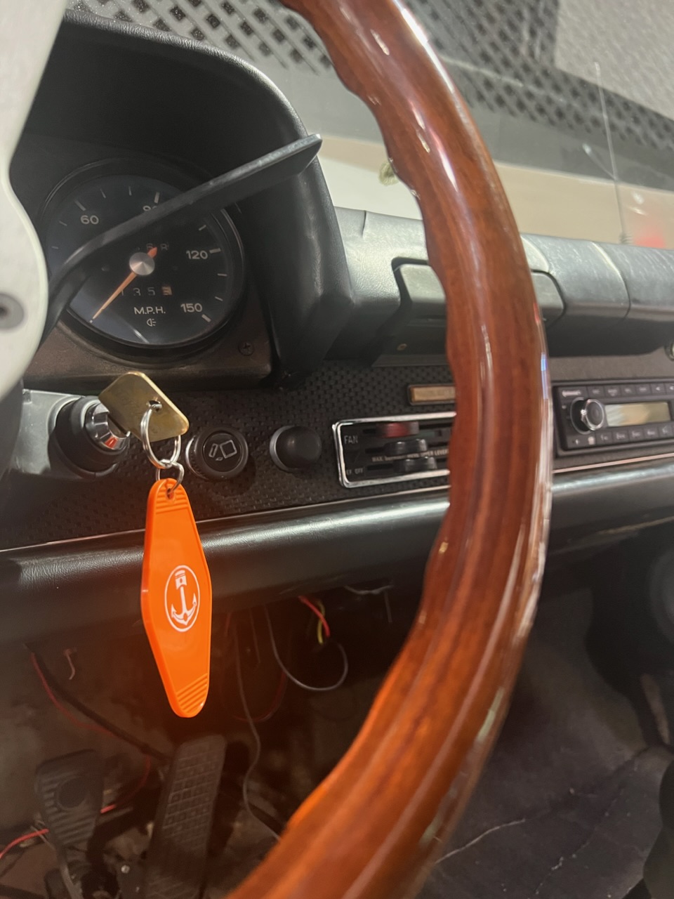

Ran into some issues with the key engaging the tumbler. Running out of time and money so decided to just use a push button. The dash already had a cut out from a 90s alarm so I just stuck it there.

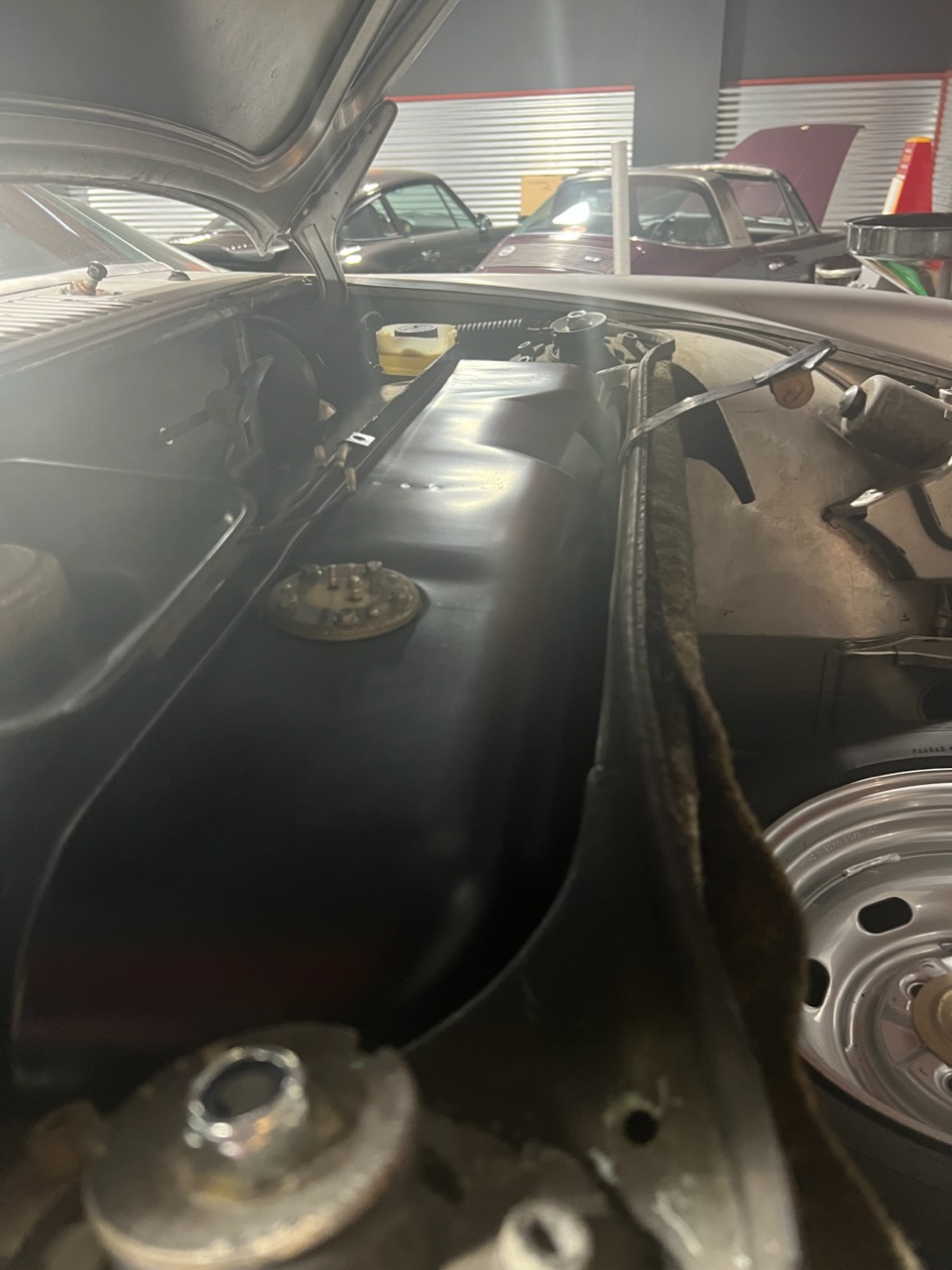

Also found a completely rusted out section in the gas tank, so had to replace that as well.

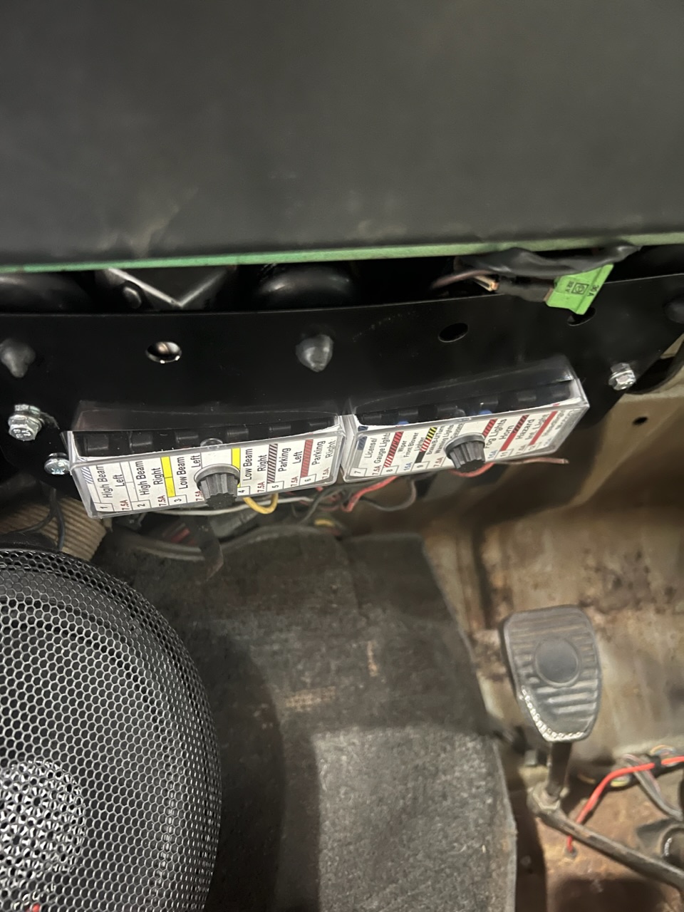

Finished up with swapping out the fuse panel for a new jwest unit. Slowing getting there!
