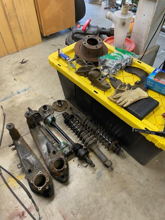

Started removing the rear suspension in order to lighten the car for the rotisserie.
Obviously planning on cleaning everything up as well. The big black bins from Home Depot will be helpful for storage. I have parts to this car everywhere and originally thought I would have enough room for everything. I was wrong.
The Black Bins are helpful and hold a lot!

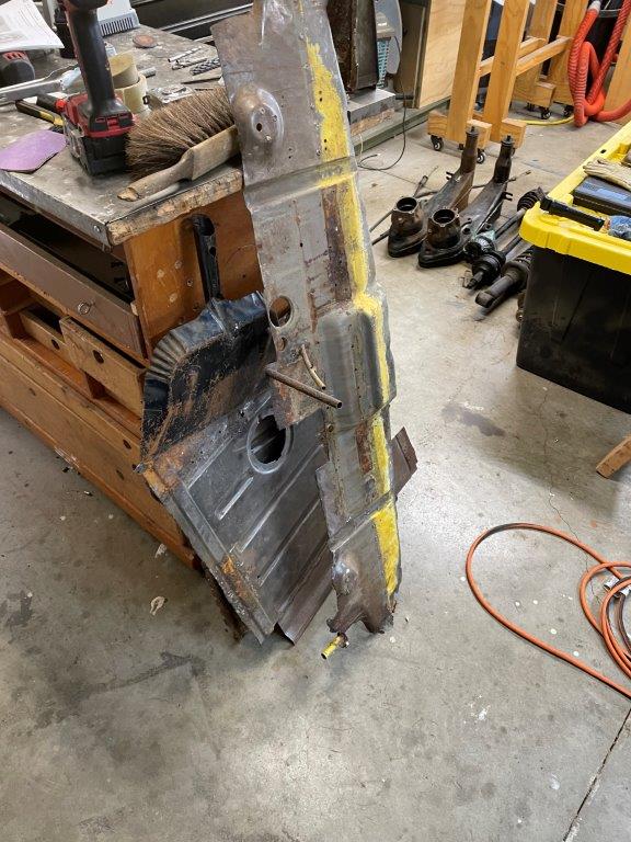

Old floor section and firewall. Going to keep these for awhile for patches if I need them anywhere. The car got picked up once by a forklift and dented the floor pan in a couple spots so I just decide to remove that section and will replace with a new RD rear section.

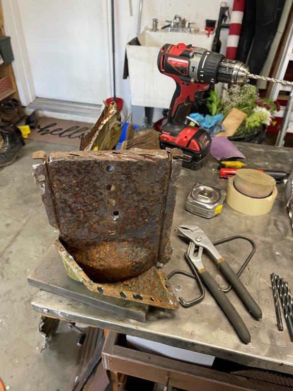

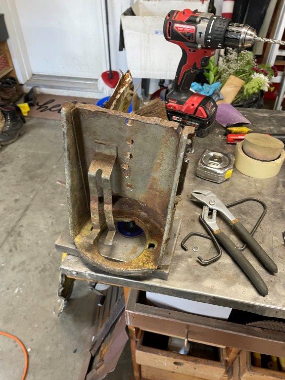

Passenger side motor mount, it is a mess on the back side. Going to see if I can clean this up at all. This is a piece I purchased from a member. True about the rust hiding behind layers!

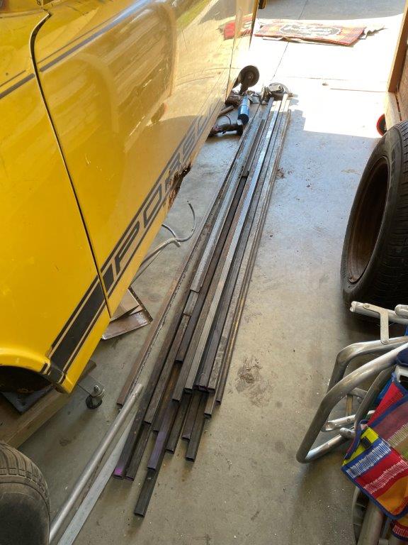

Went to Industrial Metal Supply and picked up a bunch of cut-off sections for the rotisserie. For a little over $200 I got want I needed and a set of 6" wheels. Hope to start this project over the weekend.

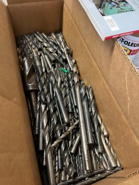

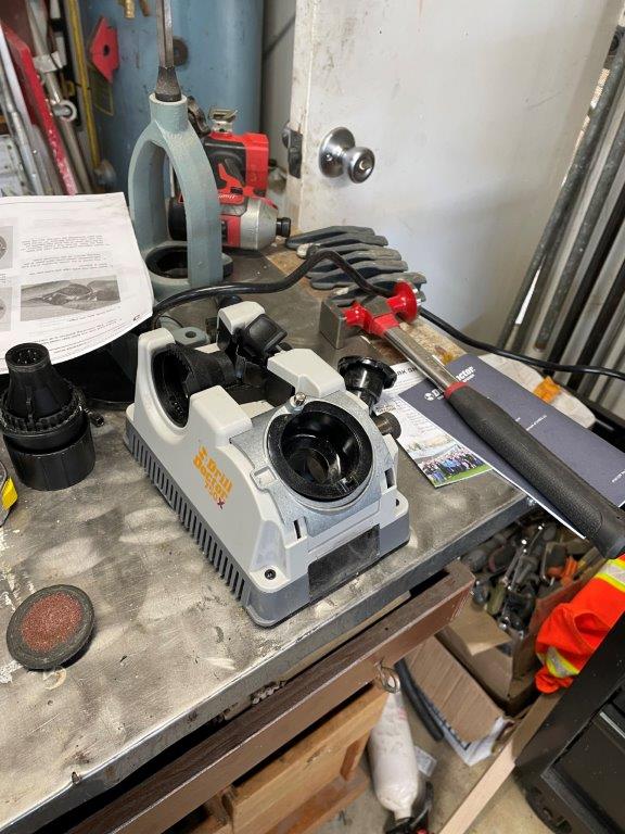

Got a box full of drill bits so I invested in a Drill Dr. The bits I currently have are a lot better than most of the crap available now so I figured for $125 I can re-sharpen the good ones and continue to use them for awhile. So far works pretty good.
Attached ImageAttached Image
