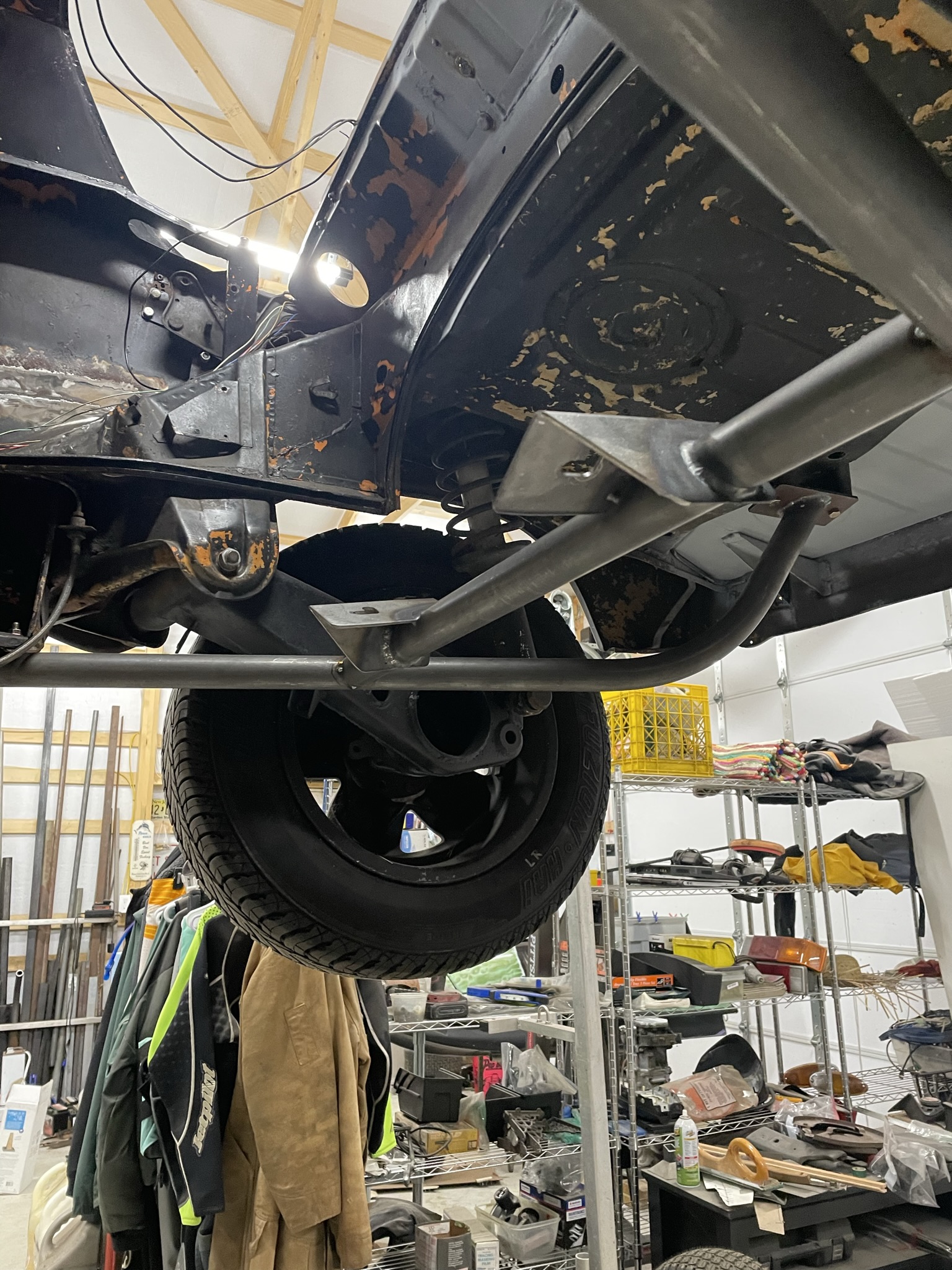

Got more done on the cradle today. Bent some 1-1/2” DOM for the longitudinal section and fabricated mount plates for the motor mount and trans mount body points. Got the longitudinals welded up and got the engine mount cross bar tacked for finish welding tomorrow. Next will be figuring out my trans mount to cradle interface.

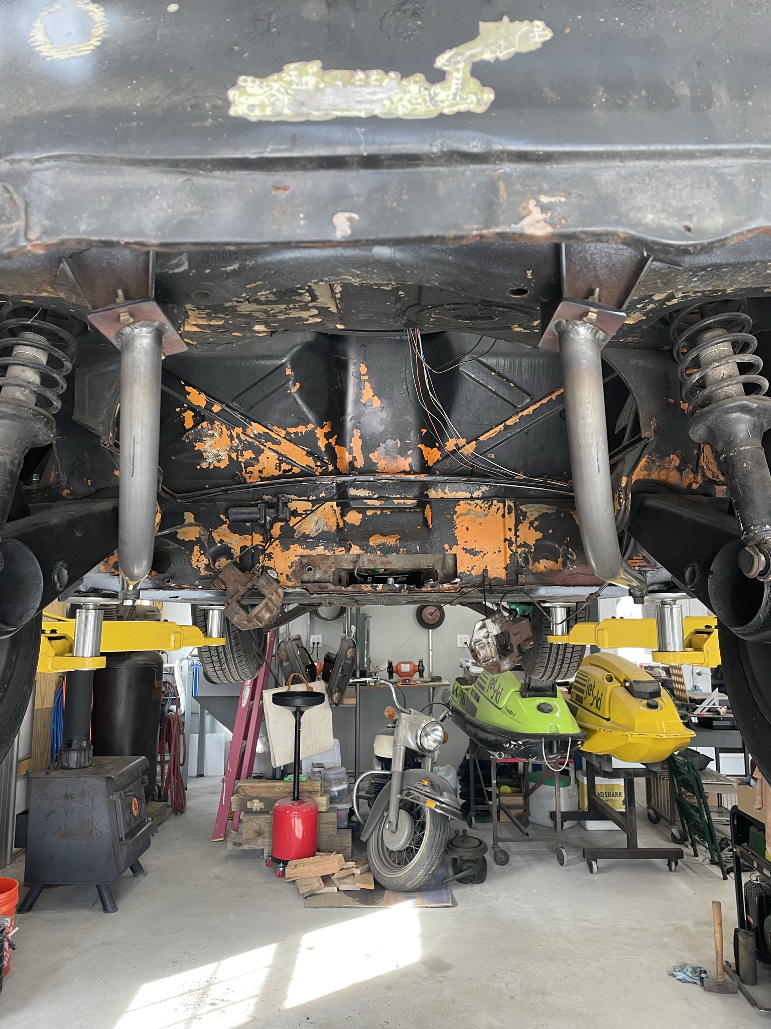

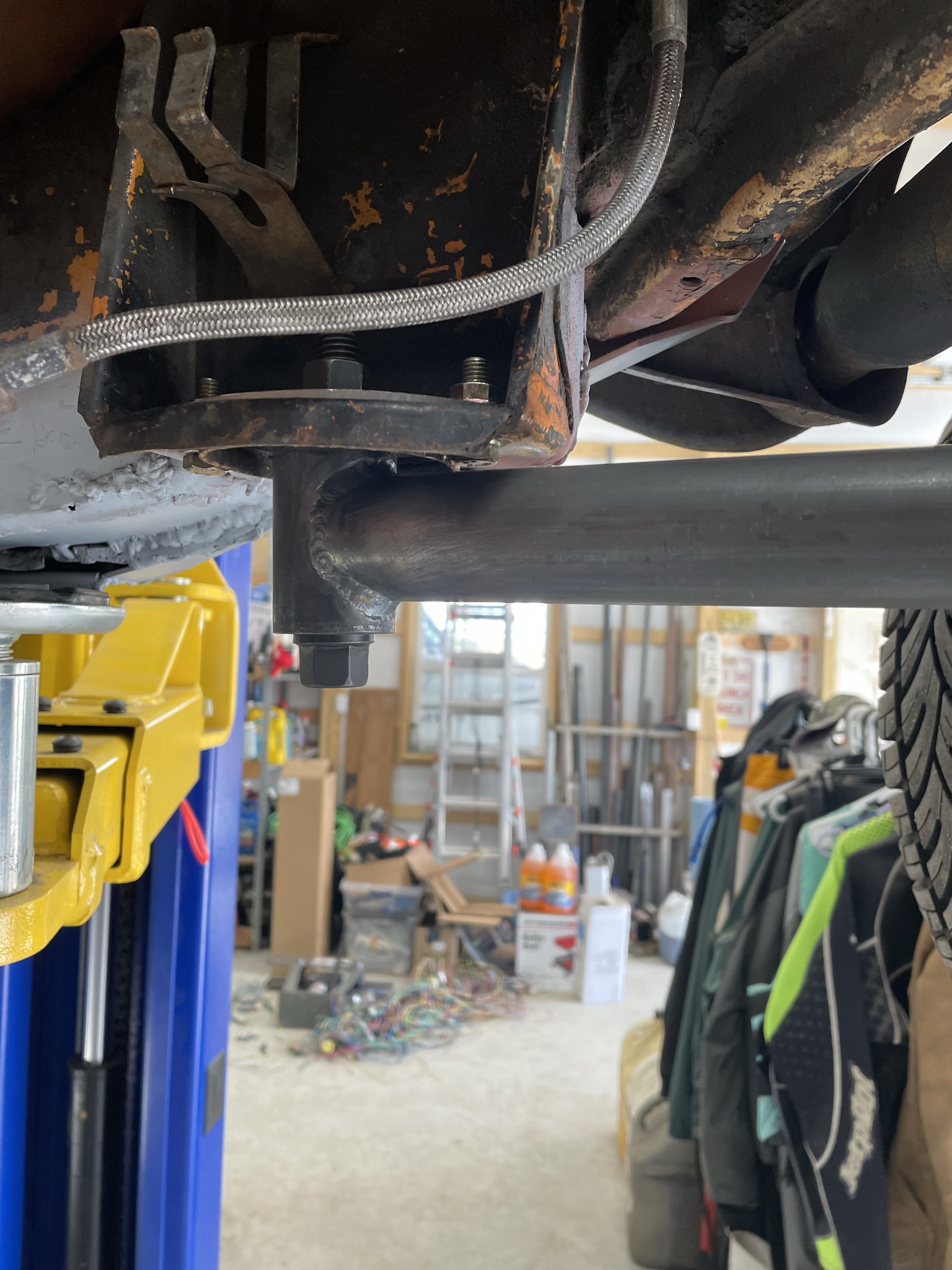

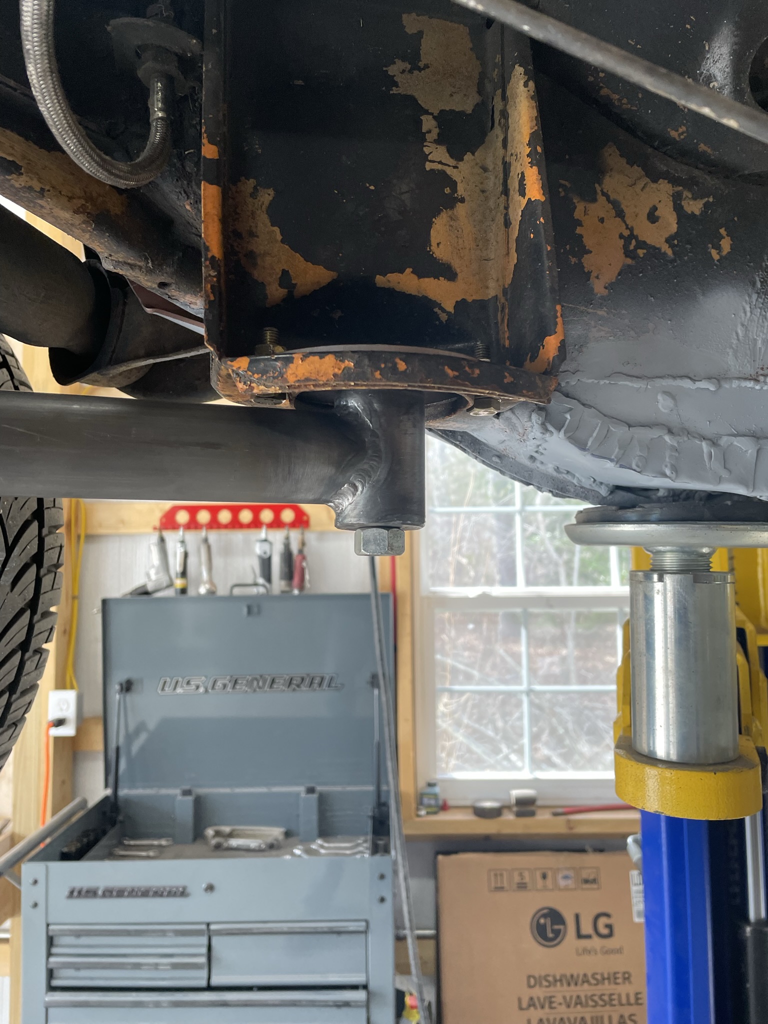

East coaster   Decided to lower the rear control arm mounts to ac...   Mar 9 2023, 08:27 PM
East coaster   Then I re-attached the box section removed in 1st ...   Mar 9 2023, 08:31 PM
East coaster   Then I cleaned up and drilled a new mounting hole ...   Mar 9 2023, 08:35 PM
East coaster   The outer trailer trailing arms spacers are doneâ€...   Mar 10 2023, 08:20 PM

East coaster   Trailing arms installed and its back on its feetâ€...   Mar 11 2023, 09:07 PM
