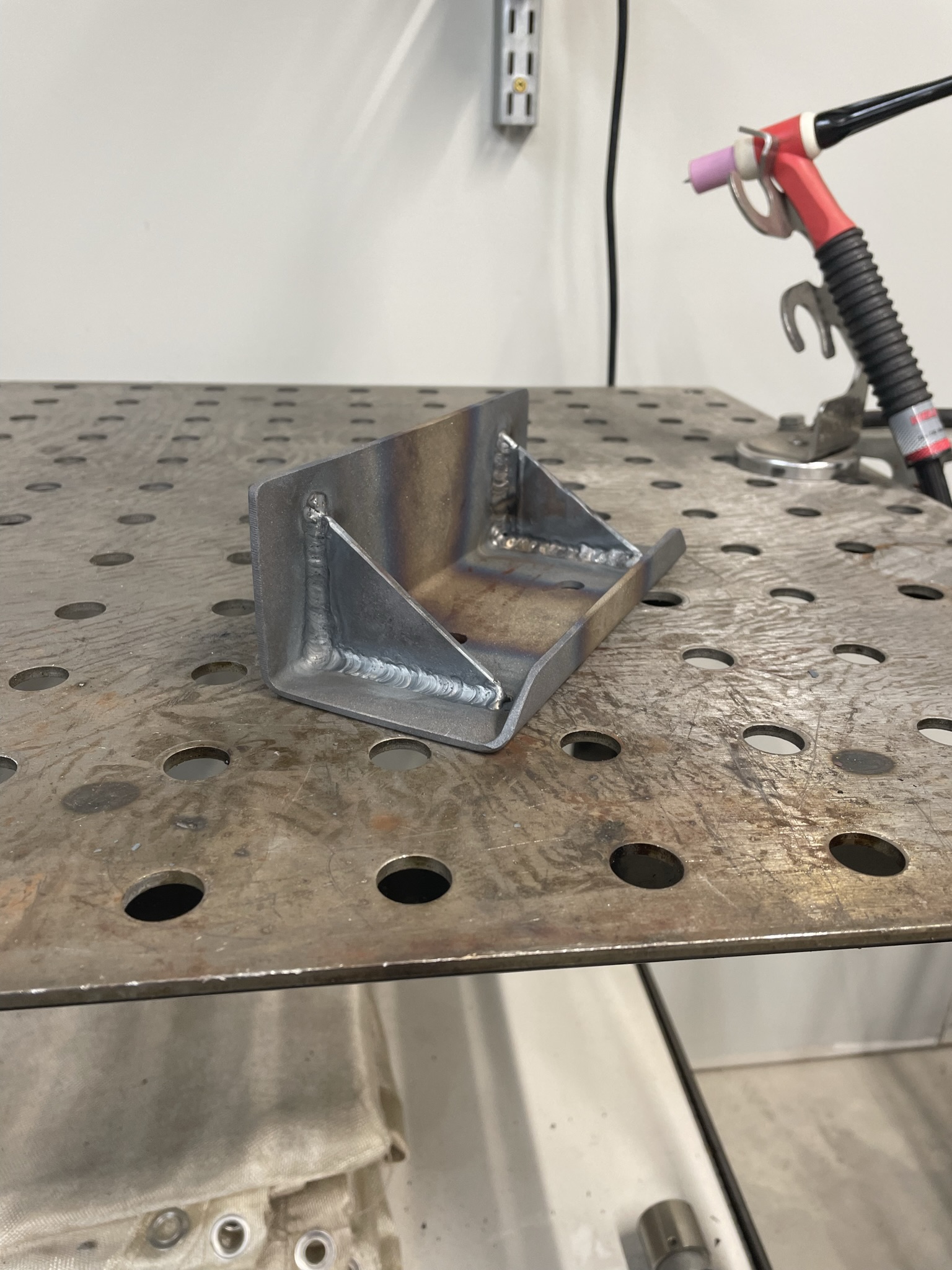

East coaster   Got more done on the cradle today. Bent some 1-1/2...   Feb 10 2023, 07:58 PM
East coaster   Fabricated the trans support and incorporated the ...   Feb 13 2023, 08:16 PM

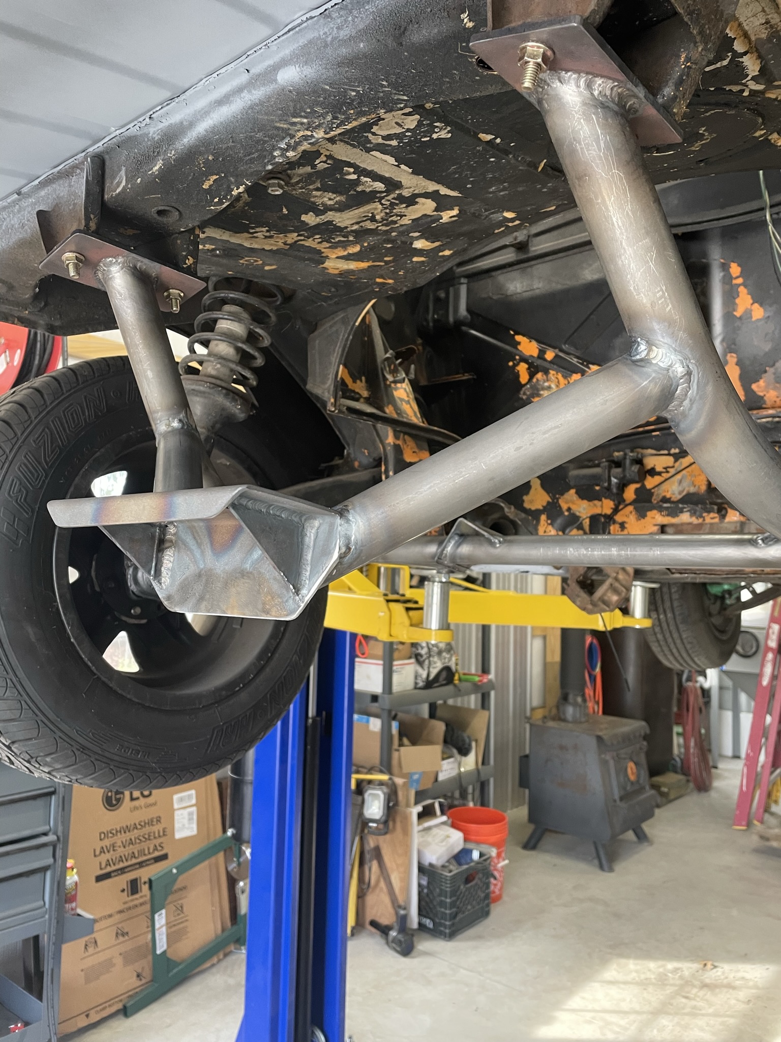

East coaster   Decided to lower the rear control arm mounts to ac...   Mar 9 2023, 08:27 PM
East coaster   Then I re-attached the box section removed in 1st ...   Mar 9 2023, 08:31 PM
East coaster   Then I cleaned up and drilled a new mounting hole ...   Mar 9 2023, 08:35 PM
East coaster   The outer trailer trailing arms spacers are doneâ€...   Mar 10 2023, 08:20 PM

East coaster   Trailing arms installed and its back on its feetâ€...   Mar 11 2023, 09:07 PM
