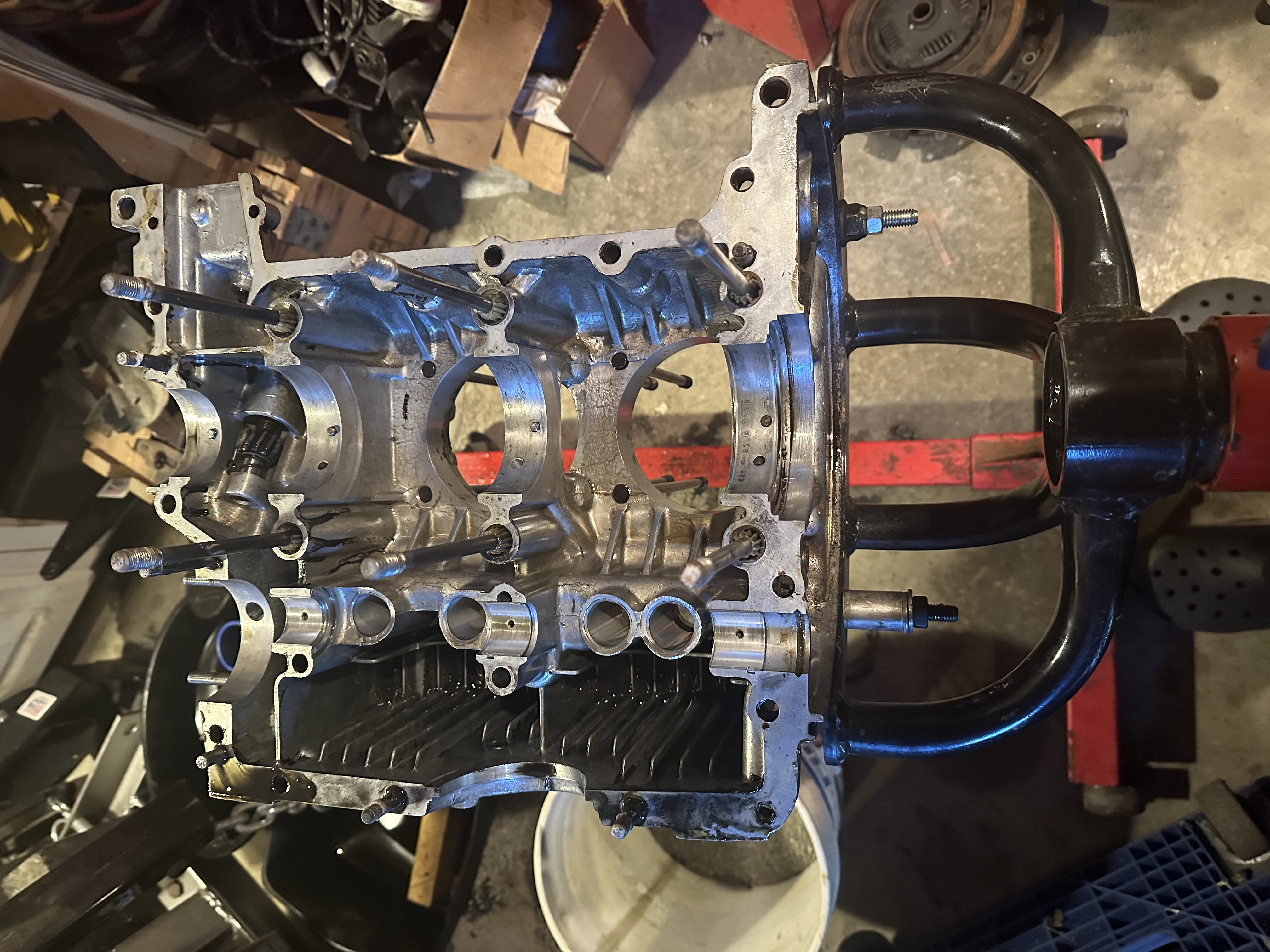

Happy day for a change in the garage
A world member set me up with a 4 post yoke for the engine stand (Thanks Nick)

914sgofast2   From your picture of the engine case mounted in th...   Feb 14 2023, 03:51 PM
rfinegan   I linked to the Raby live stream in post 19 Now th...   Feb 14 2023, 04:38 PM
