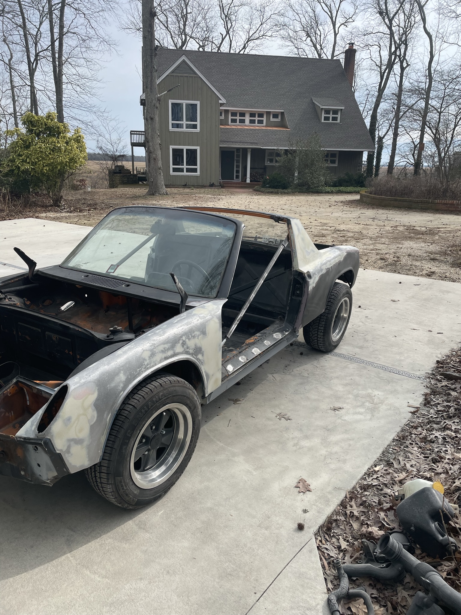

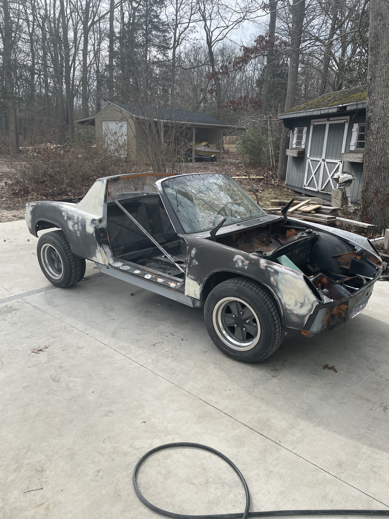

East coaster
post Feb 17 2023, 06:39 PM
Posts: 1,992
Joined: 28-March 03
From: Millville, NJ
Member No.: 487
Took advantage of some unseasonable February weather and got a jump on the body work. It’s shaping up nicely after the metal work.
