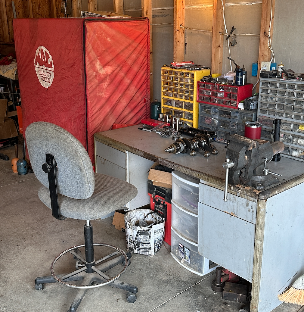

barefoot   You keep your tools in the dark ??   Feb 19 2023, 05:47 PM
rfinegan   Old trick of the trade...no one asks to borrow any...   Feb 19 2023, 06:45 PM
