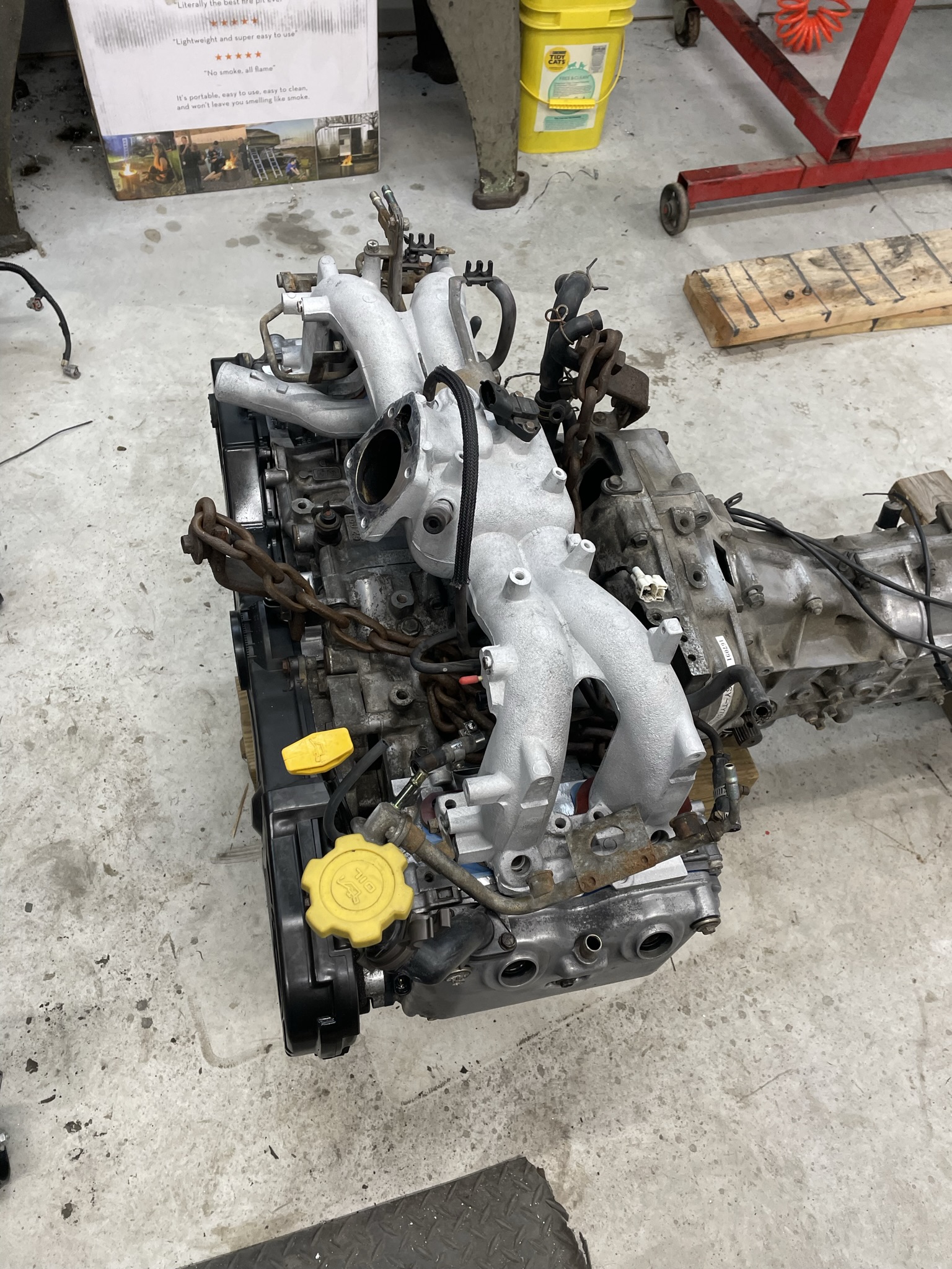

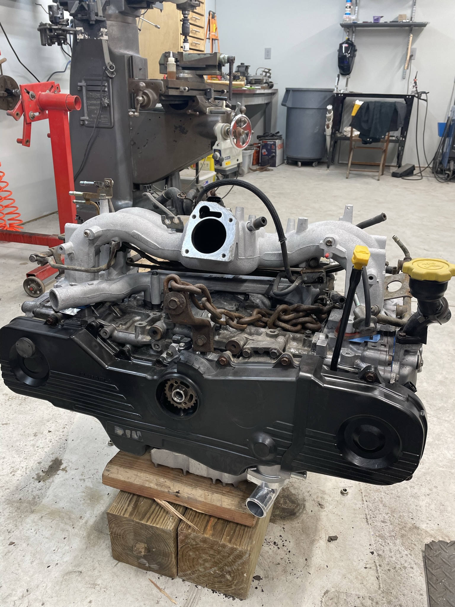

My focus on my project has been all over the map, mostly driven by our crazy Northeast weather. Today was an inside shop day and I started working my intake manifold flip. I stripped my intake and glass beaded the intake to clean it up. The flip is mechanically pretty straight forward, need just an 8mm spacer to raise the manifold enough to provide clearance for the fuel hard lines. The harder part will be re-wiring the harness a bit to account for the movement of the sensors, but even that shouldn’t be too difficult.
