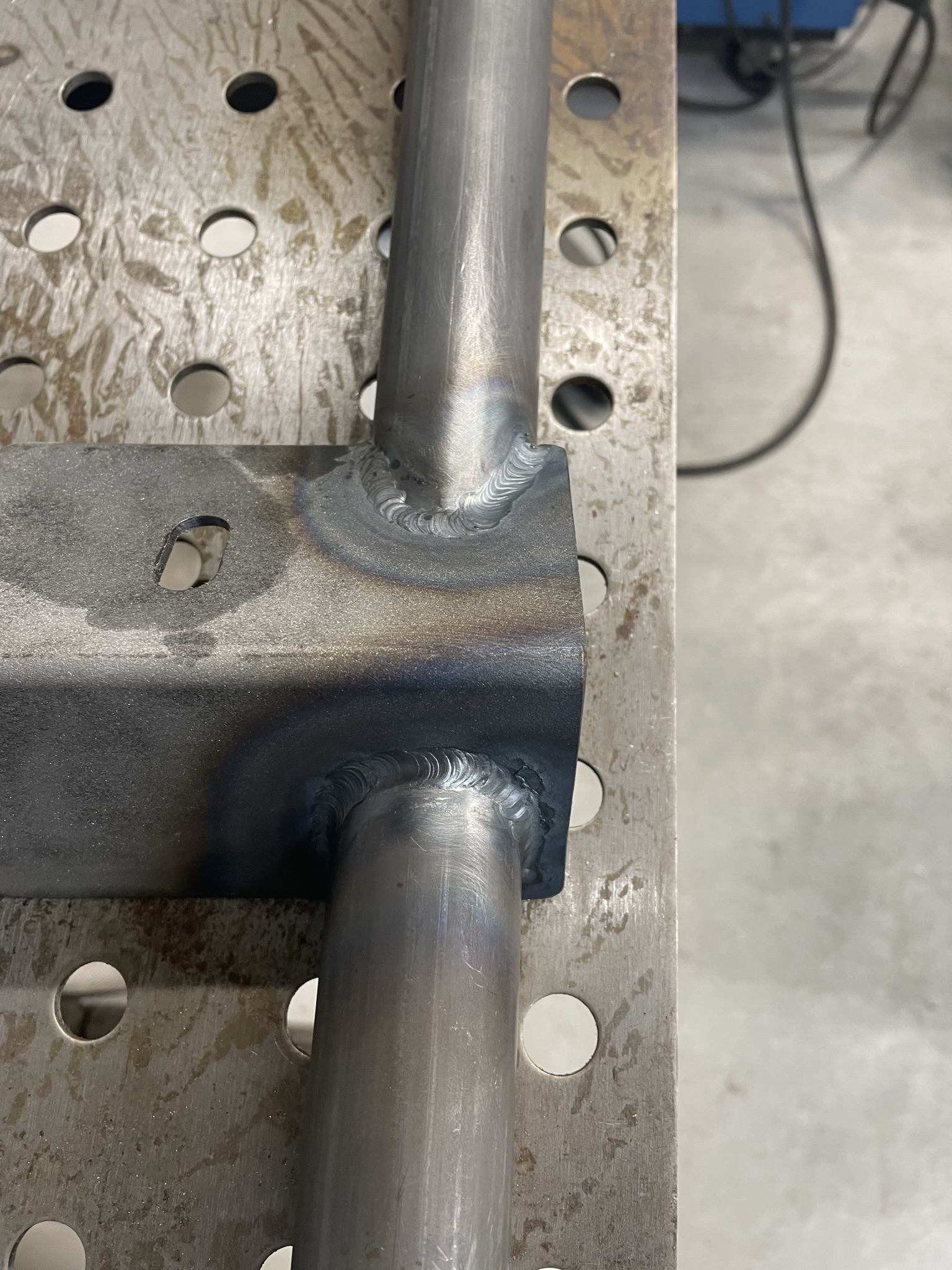

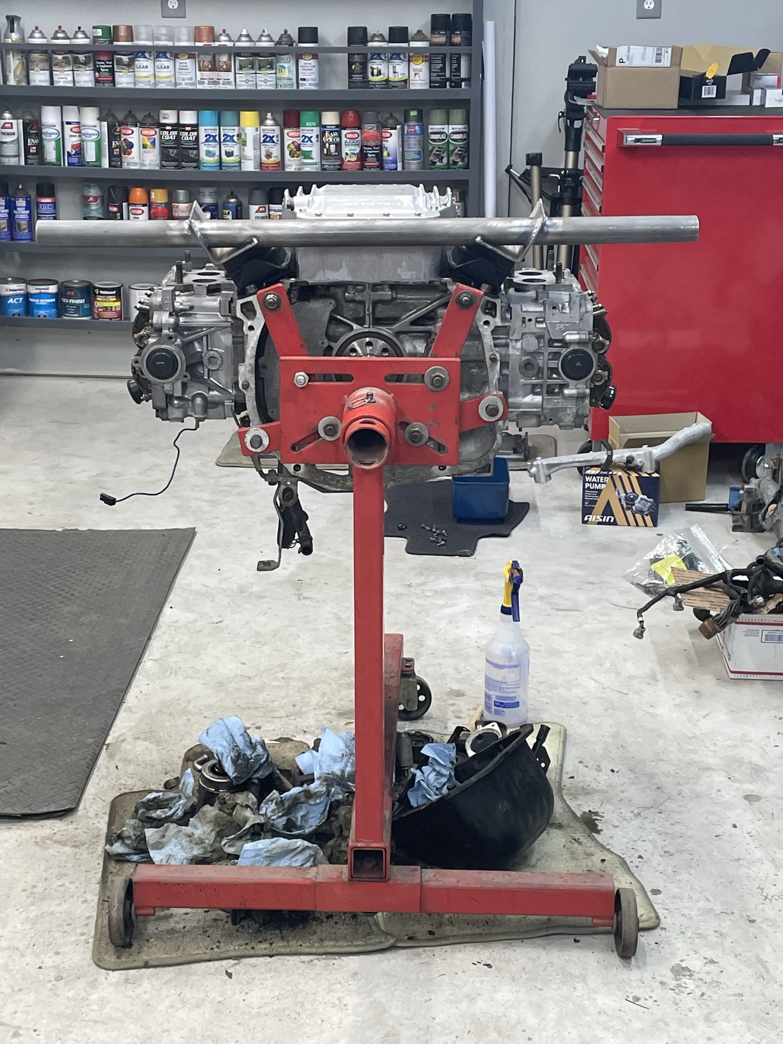

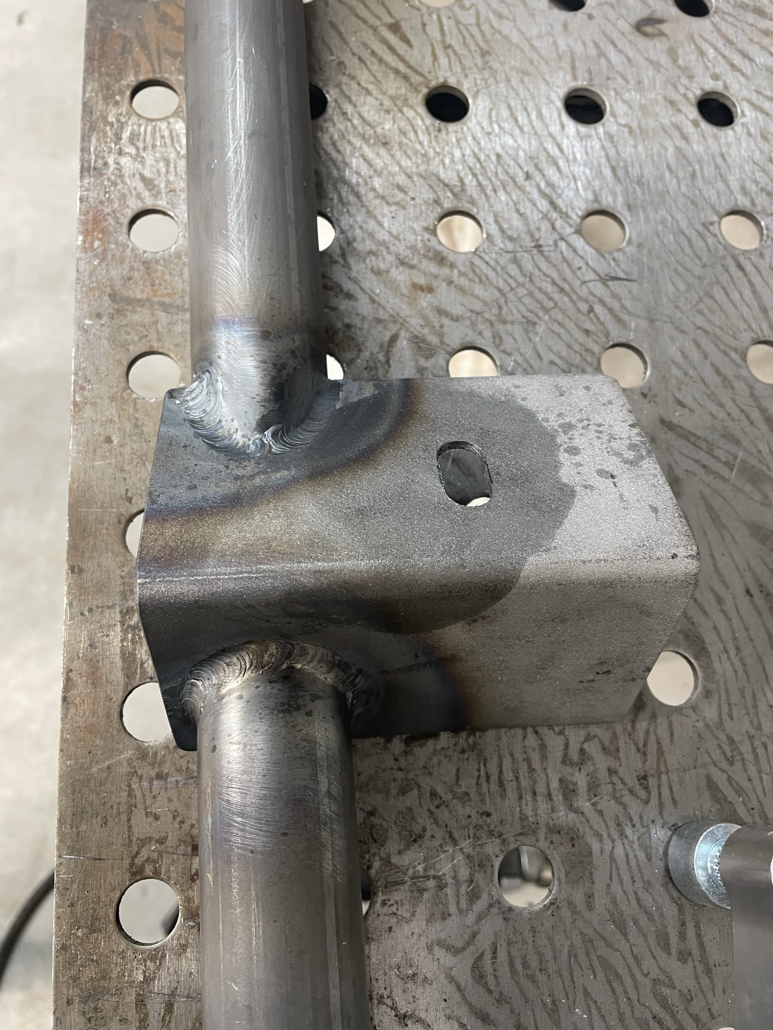

While the engine was upside down, I started fabricating the engine mount/cradle. Here’s the cross bar and motor mount plates coming together. I left the cross bar a little long until final fitting in the longitudinal cradle bars.

QUOTE(East coaster @ Feb 7 2023, 05:14 PM) *
Nice welds there...you've definitely got some skills in this department.
I took an intro to welding class (MIG) this fall, and it's not easy by any stretch.
