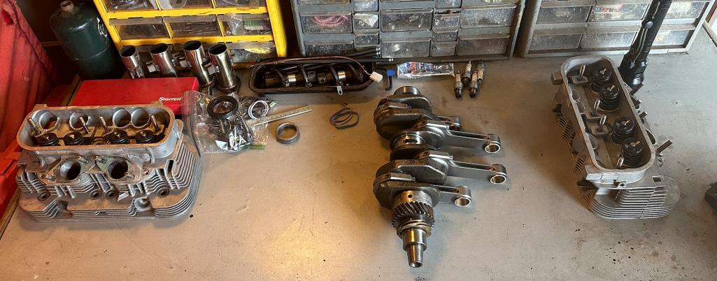

Heads are repaired with new intake guides and 3 angle valve job (300.00):-)
NOT A CLEAN ROOM but good for measuring and inspection...Attached Image
