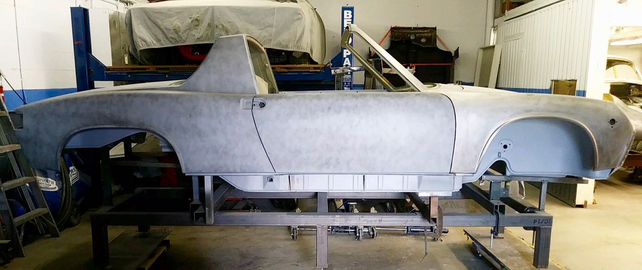

Here is the best shot I have of my car when we were getting it ready for paint. I looked through all of my pictures and can't find one that is a better shot of that area:
