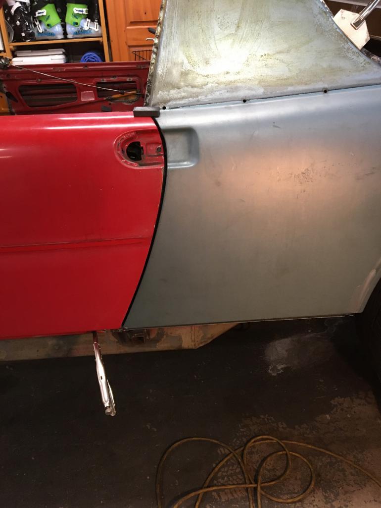

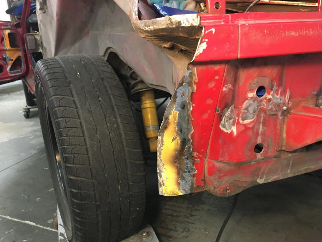

OK, so let's continue with this problematic lower dented corner. After trying to hammer it back to match the shape of the fender, I realiazed I had cut to much material off of it and was left with too large of a gap. (IMG:style_emoticons/default/rolleyes.gif) (IMG:style_emoticons/default/headbang.gif)

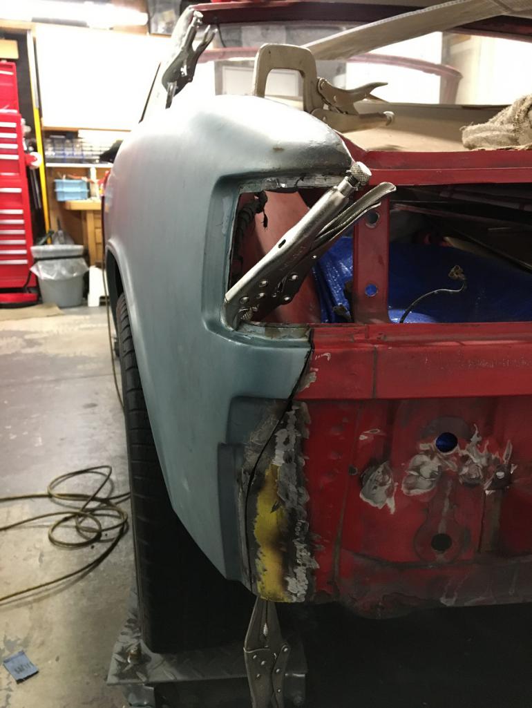

So, luckily among my various sheet metal parts, I had one from the yellow fender piece. So here it is now attached to the car and nicely matching the new fender.
And now with the fender nicely matching ready for the butt weld.

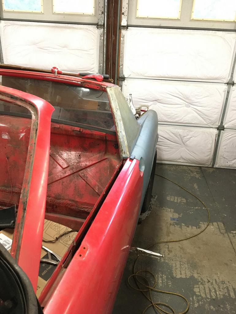

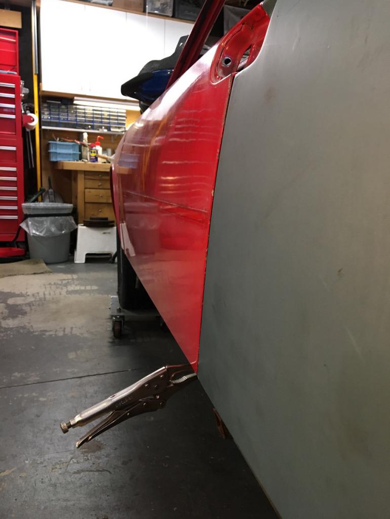

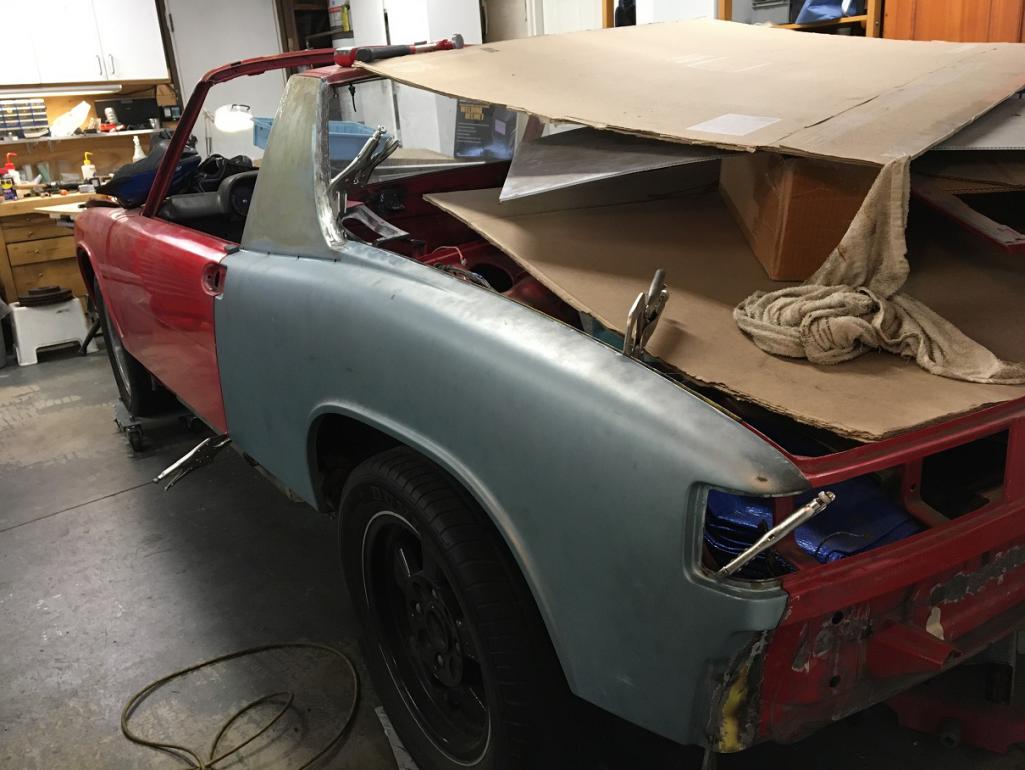

After many subtle little adjustments and on and off, I want to think the fit is pretty much ready for welding! (IMG:style_emoticons/default/smile.gif)
The door gap is pretty uniform at 5.27mm near the top and 5.08 at the bottom held by a few vise grips. Let's hope it stays during welding...
More pictures of it simply held by a few clamps.
Next, prepping the surfaces and weld! (IMG:style_emoticons/default/smile.gif) (IMG:style_emoticons/default/beer3.gif)
