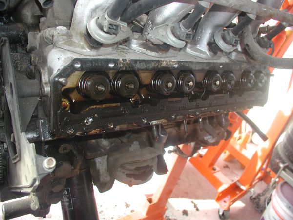

While Rick is up working in the cold I am down here with the Dog House doors wide open. This is what I got into today. I pulled more stuff off to get ready to take the heads off so I can get them over to the shop and get the exhaust studs replaced.
