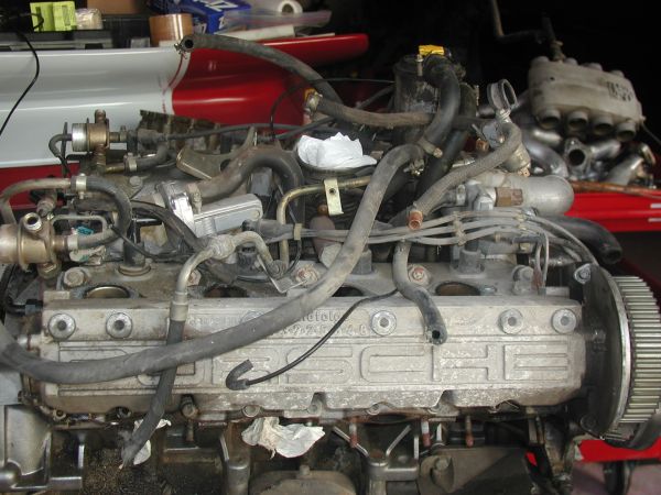

I figure I will start the build thread. I have the 18 X18 X1 inch plate for the adapter I need to get this sent up to Rick so He can grind it into shape while I get the engine running consistantly (IMG:style_emoticons/default/mueba.gif) I have already sold off some of the 928 parts to fund this thing. I will update this thread as we go along this pathway to fun. (IMG:style_emoticons/default/wacko.gif)

I took the spider off

spare time toys   While Rick is up working in the cold I am down her...   Jan 19 2005, 06:28 PM
spare time toys   Some of the 928 guys said to watch out for the puc...   Jan 19 2005, 06:31 PM
spare time toys   I took the spider off   Jan 19 2005, 06:32 PM
spare time toys   Now Ill polish or powder coat this stuff   Jan 19 2005, 06:36 PM
