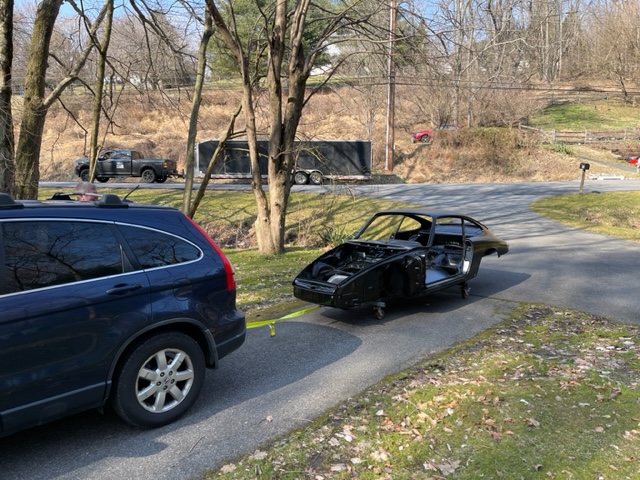

We had to take your car off the truck to get to mine. So it’s touched ground in Landenberg PA for a moment. Then back on the truck.
Had to pull mine up my hill to get it into the garage.

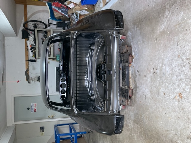

mepstein   We had to take your car off the truck to get to mi...   Feb 26 2023, 07:13 PM
Tom1394racing   Mine is back home as well. I am pretty happy with ...   Feb 28 2023, 03:40 PM
