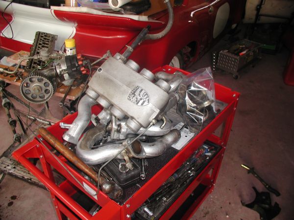

spare time toys   While Rick is up working in the cold I am down her...   Jan 19 2005, 06:28 PM
spare time toys   Some of the 928 guys said to watch out for the puc...   Jan 19 2005, 06:31 PM
spare time toys   I took the spider off   Jan 19 2005, 06:32 PM
spare time toys   Now Ill polish or powder coat this stuff   Jan 19 2005, 06:36 PM
