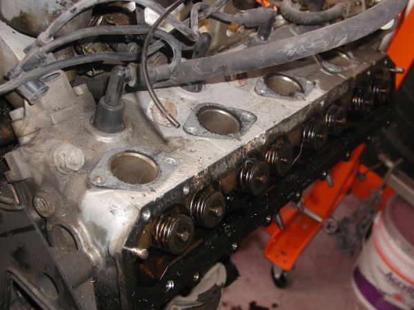

spare time toys   Well I got the head off on the left side today bef...   Jan 20 2005, 06:28 PM
spare time toys   Now the uglyness I broke an allen wrench off in on...   Jan 20 2005, 06:32 PM
