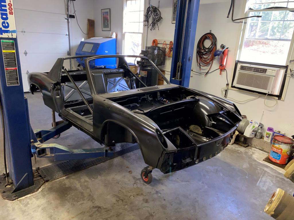

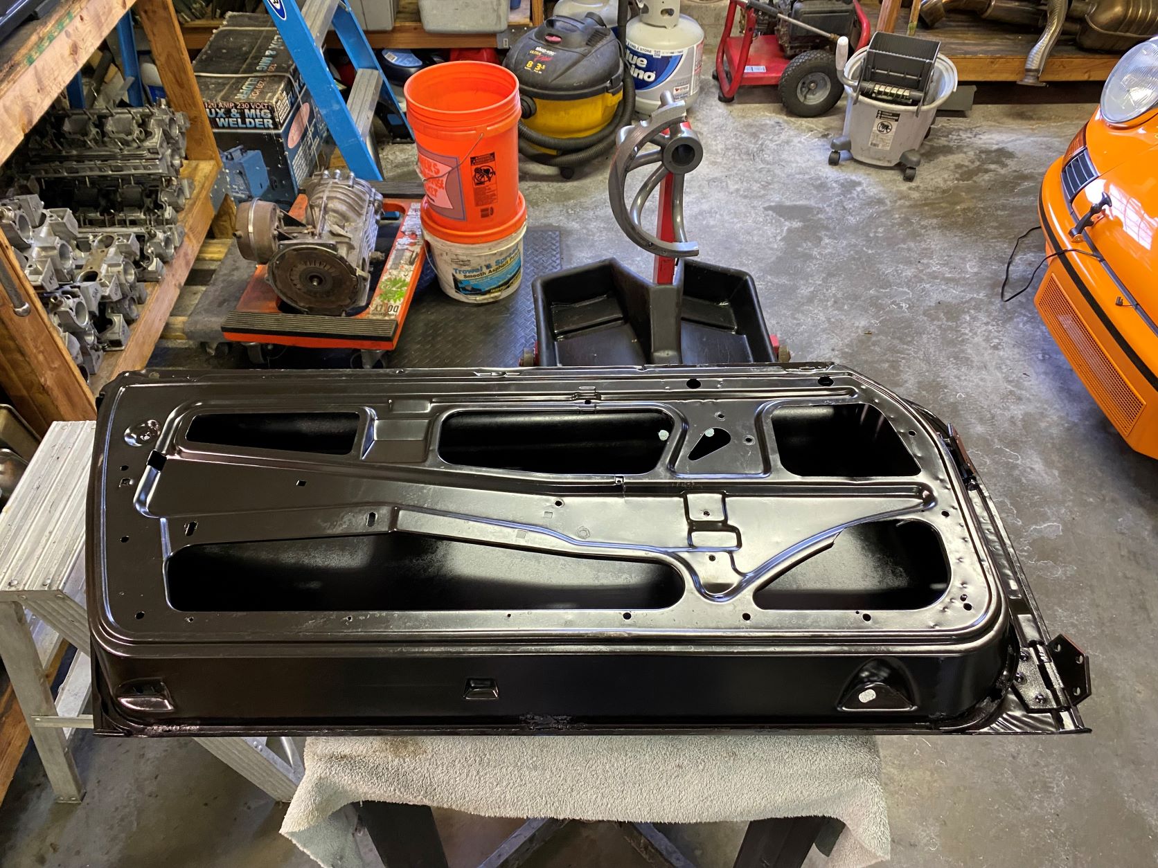

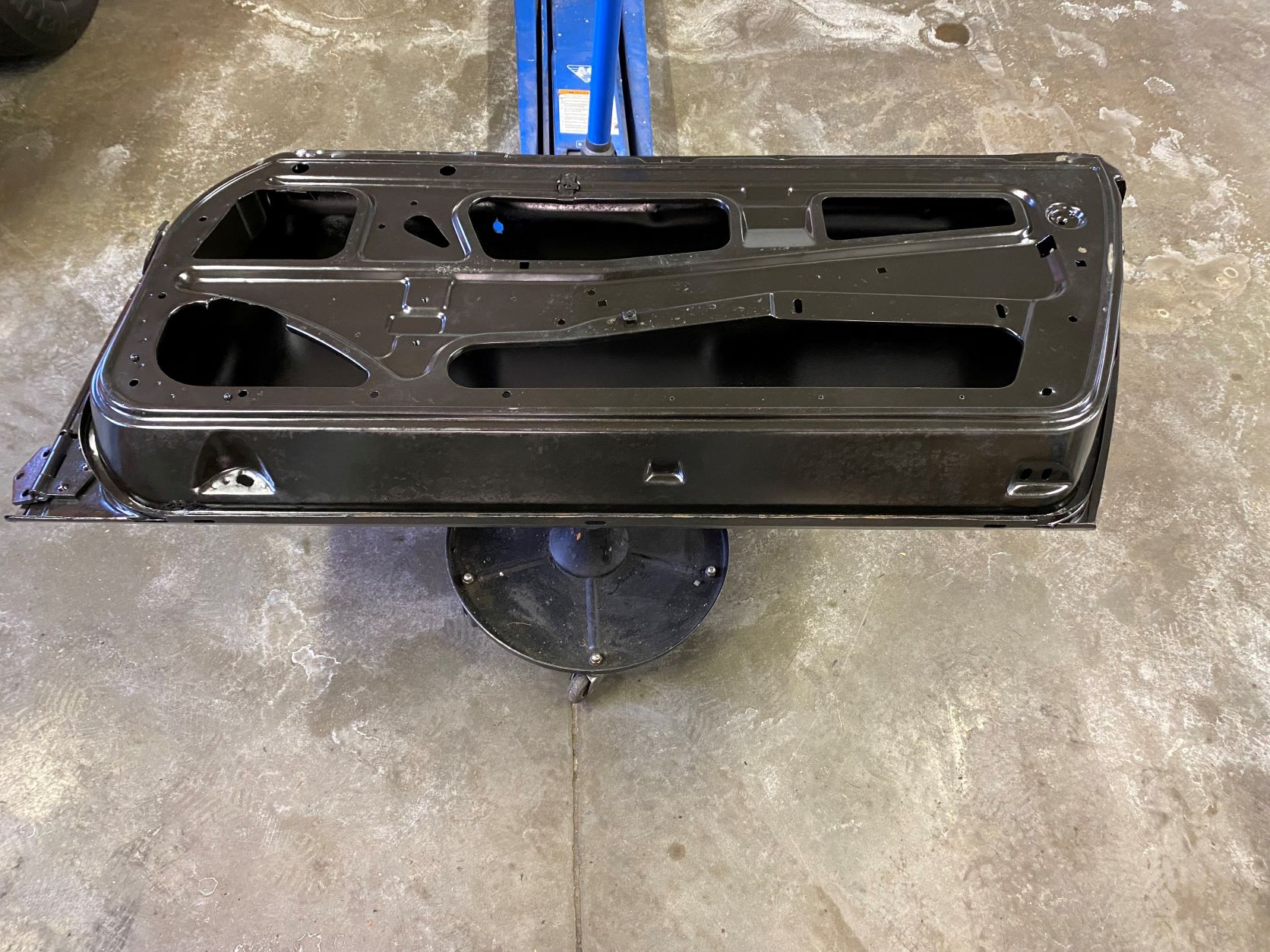

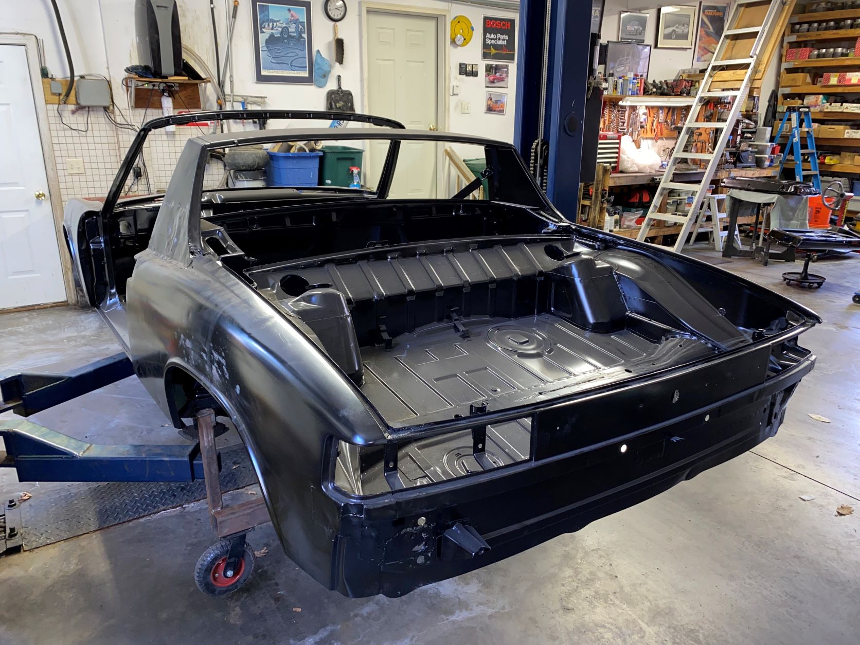

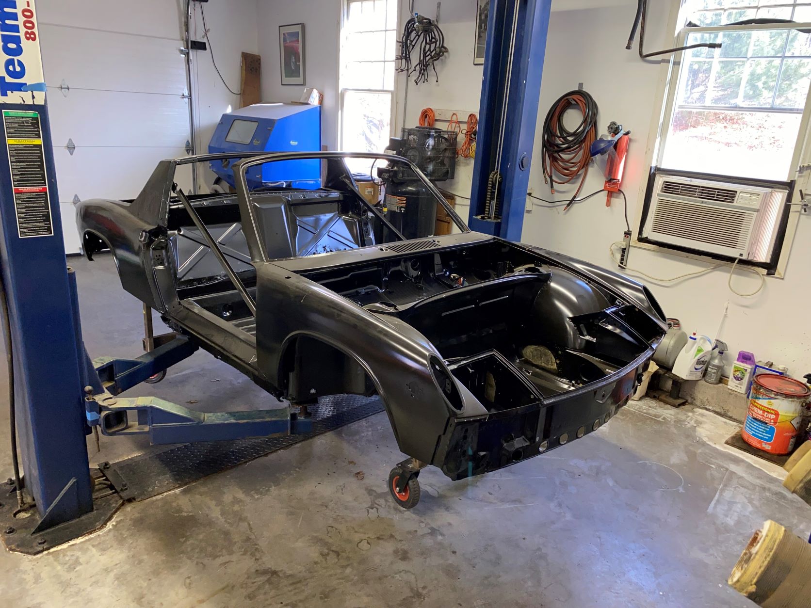

Tom1394racing   The chassis has now completed the dipping/E-coat p...   Jan 27 2023, 01:39 PM
mepstein   I just talked to Neil the other day. Our cars migh...   Jan 27 2023, 03:22 PM
Tom1394racing   Yes Mark...I spoke to Neil this afternoon.   Jan 27 2023, 04:03 PM
mepstein   We had to take your car off the truck to get to mi...   Feb 26 2023, 07:13 PM
Tom1394racing   Mine is back home as well. I am pretty happy with ...   Feb 28 2023, 03:40 PM

Tom1394racing   After the extensive rust repair, the GT conversion...   Feb 28 2023, 04:09 PM
mepstein   The dip and e-coat make the good metal look really...   Feb 28 2023, 04:56 PM
