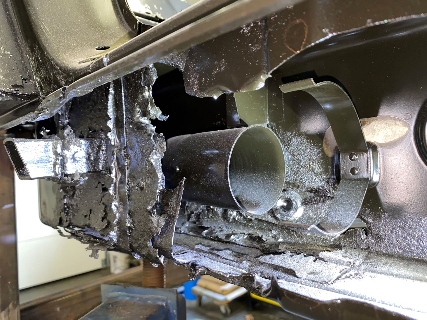

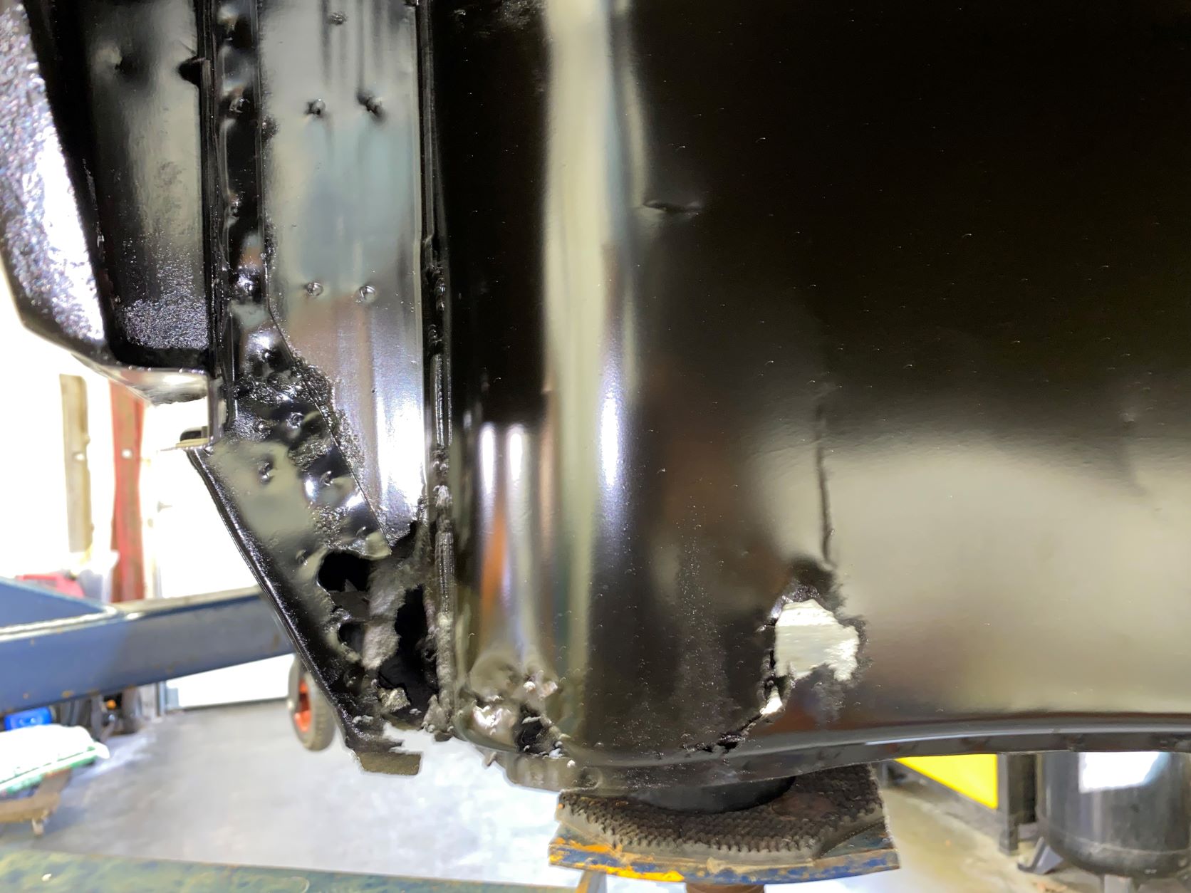

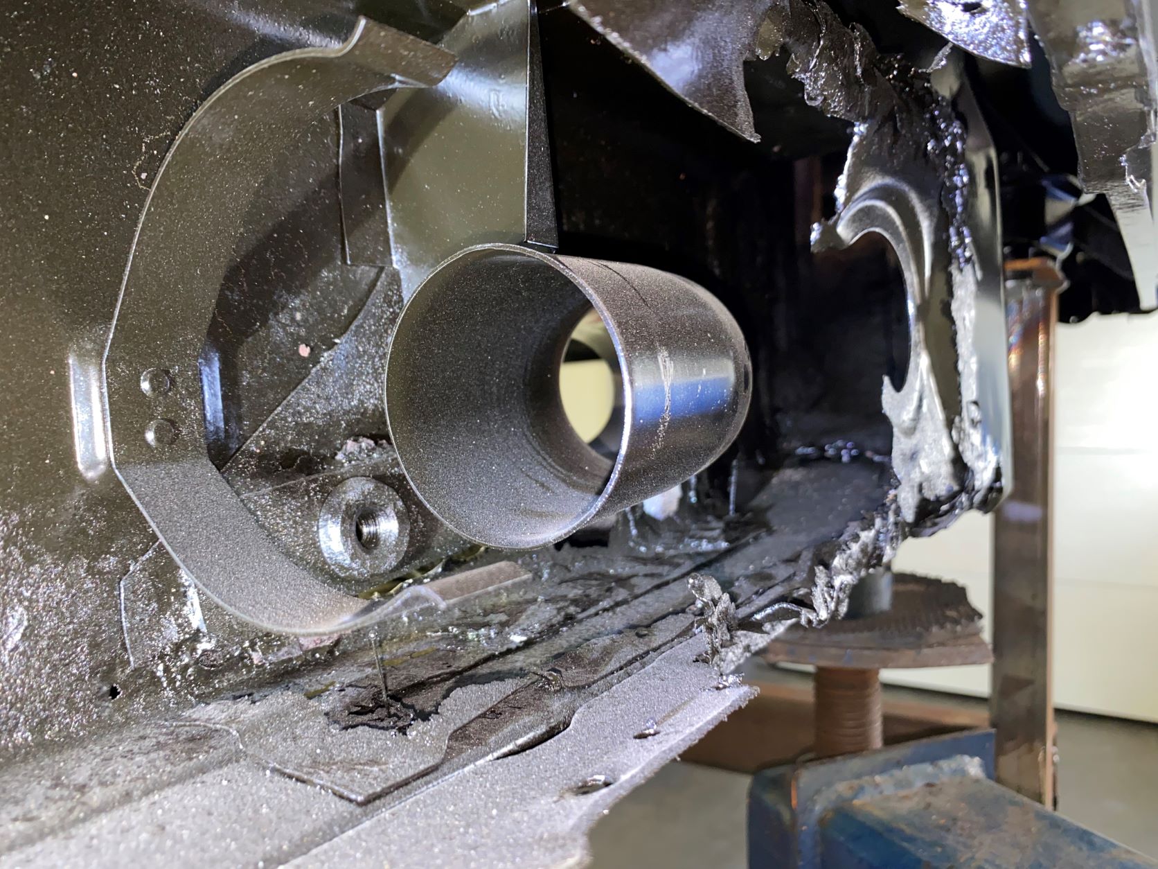

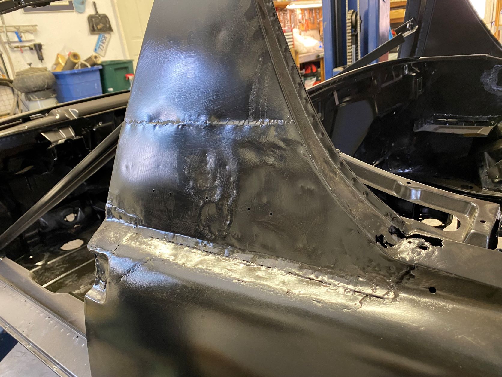

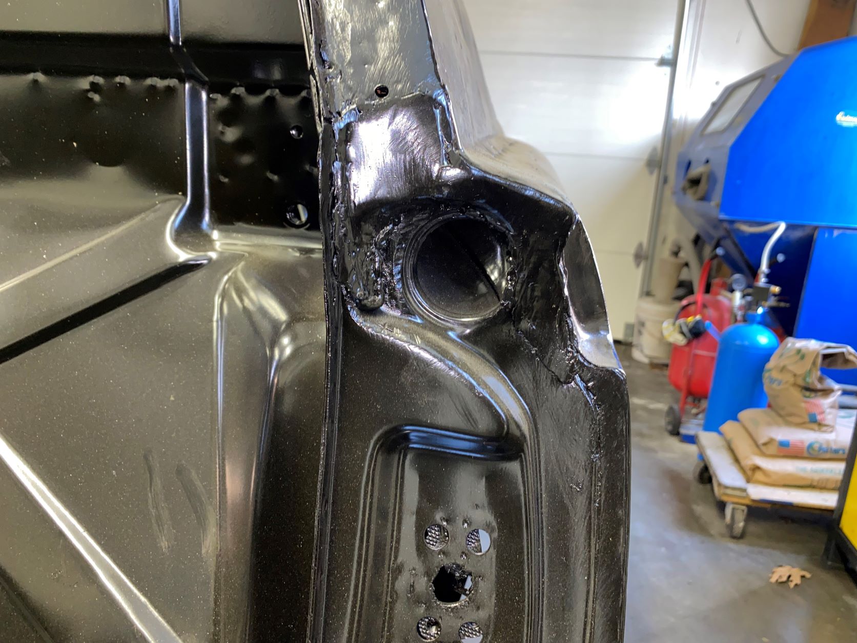

Here are some examples of the nasty hidden sins that will be corrected by Auto Associates
Attached Image Attached Image Attached Image Attached Image Attached Image Attached Image

Tom1394racing   Here are some examples of the nasty hidden sins th...   Feb 28 2023, 04:02 PM

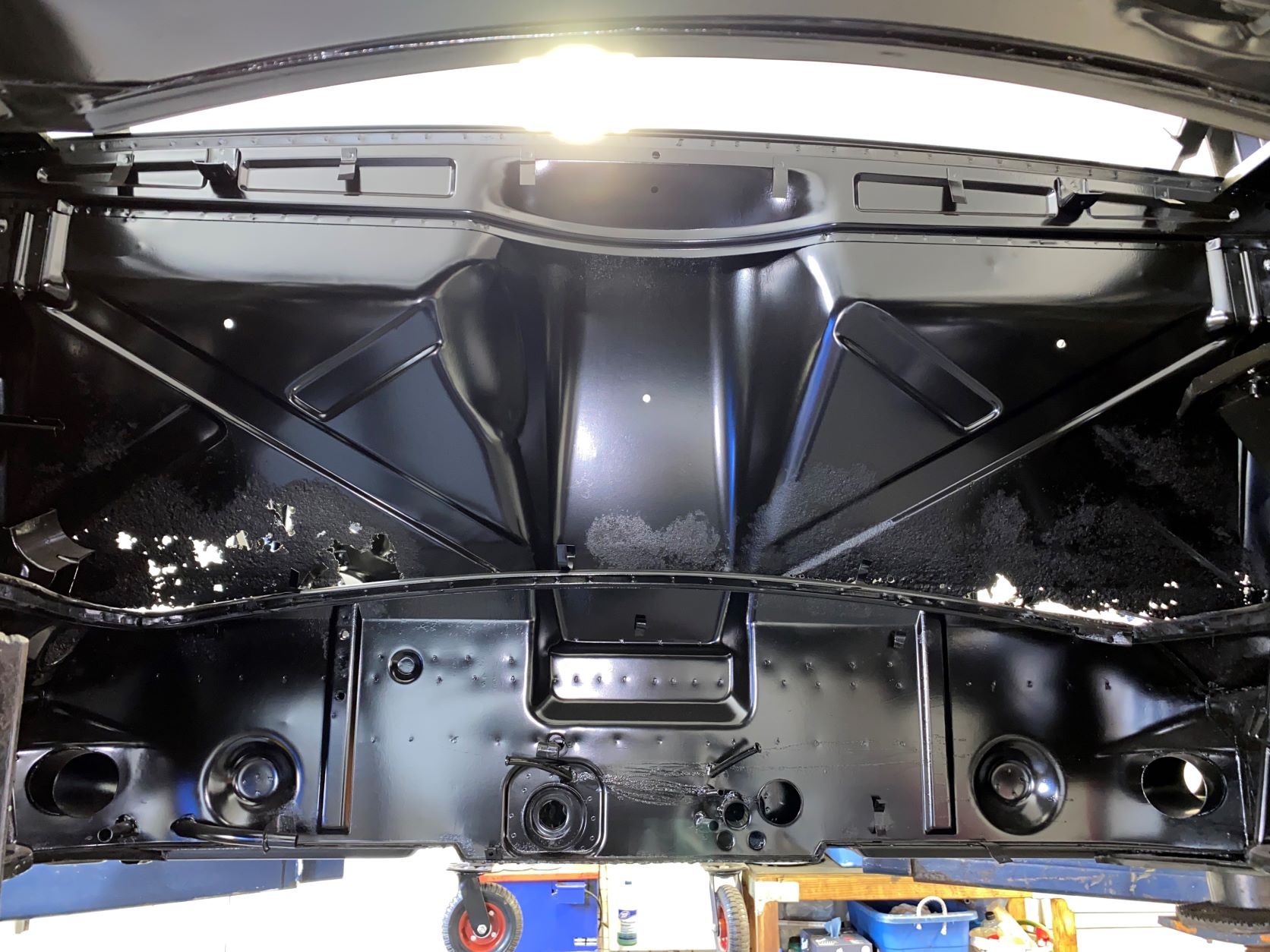

Tom1394racing   After the extensive rust repair, the GT conversion...   Feb 28 2023, 04:09 PM

Tom1394racing   Update - The car was delivered to Auto Associates ...   Apr 18 2023, 12:54 PM
Tom1394racing   The rust repair has started with removal of the ru...   Apr 18 2023, 01:07 PM
