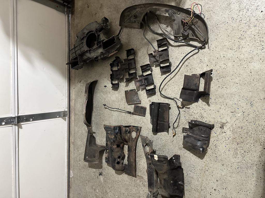

I am starting to reassemble my 1975 2L engine after tearing it apart 20 years ago. As it has been a long while since I started the teardown, I don't remember where and what all the pieces are. It would be awesome if anyone would send/post me a photo showing all the pieces and where they go (of the complete engine tins). Even better if anyone could tell me if a source of aftermarket engine tins can be found.

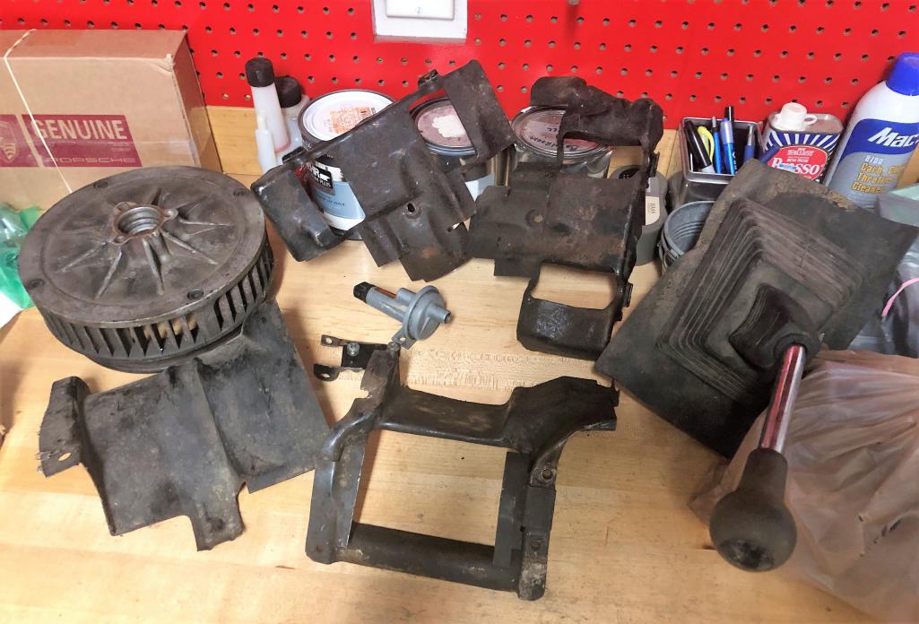

I have a few pieces #'s 5, 5A, 17 & 24 of a 1974 1.8 motor if tshid914 needs them.
See photo
Tom Michigan

Thanks Tom in Michigan, after you sent me those pieces I found the others except for #32 and 33 in my shed. They will be cleaned and wire brushed then surface rust will be converted with VHT rust converter then painted with POR15Attached Image
