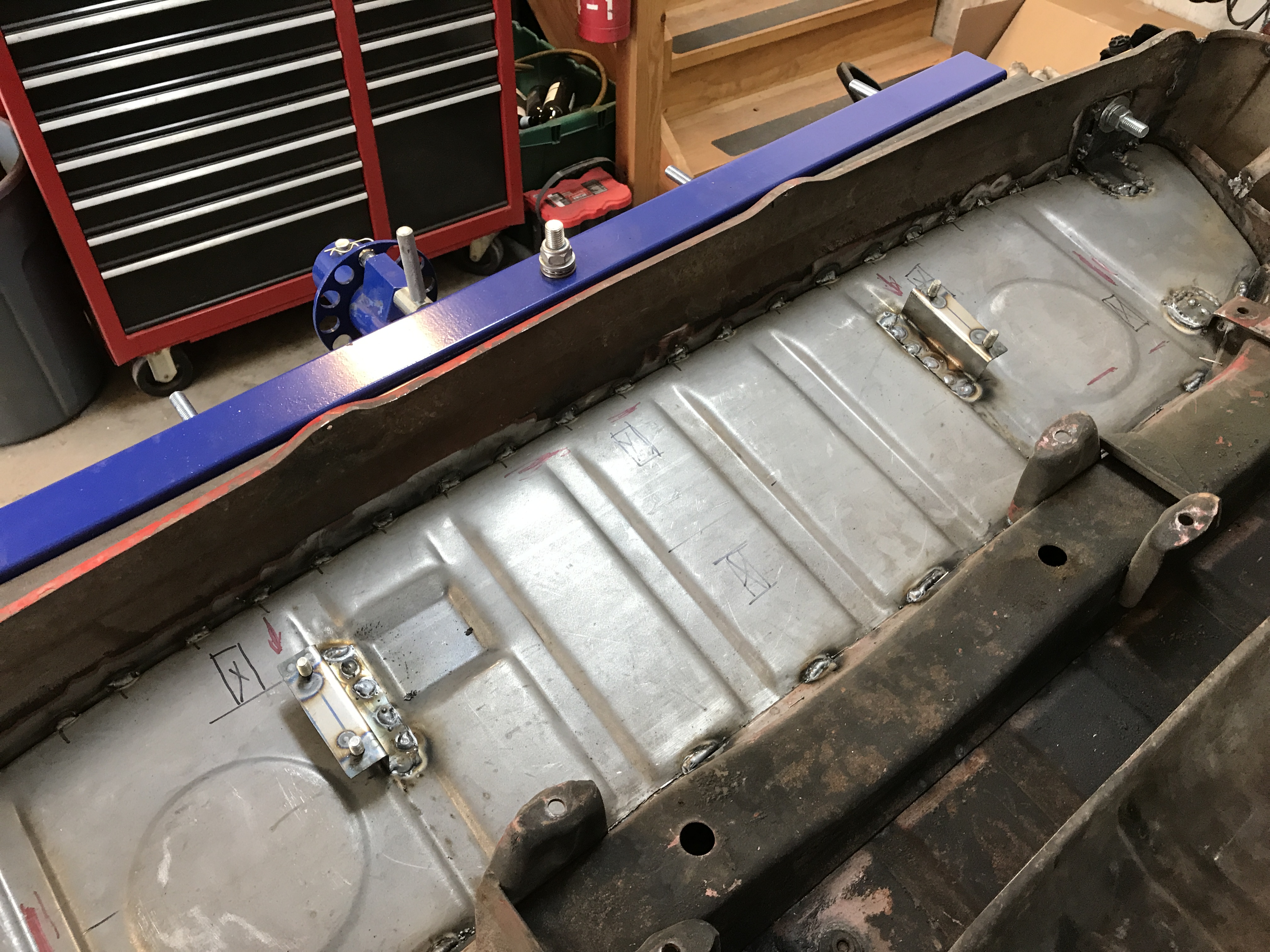

bkrantz   Here's my 73 muffler shield bolt-on modificati...   Mar 4 2023, 10:04 PM
bkrantz   Brackets welded to the trunk floor.   Mar 4 2023, 10:05 PM
bkrantz   Shield bolted on. All this was before I did paint...   Mar 4 2023, 10:07 PM
