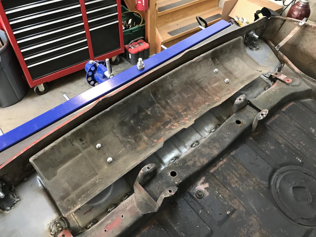

Mine is missing and what is left behind looks like someone took a pair of pliers and yanked it off during a pit stop.
Is this part available just as a shield or part of a trunk patch? I looked at a couple of suppliers but I am not finding anything.

Shield bolted on. All this was before I did paint. I eventually had the shield powder-coated with high-temp powder.

SA-914   I ended up welding nuts to the underside of the sh...   Oct 4 2022, 02:47 PM
NARP74   I don't weld, but I could do nutserts or somet...   Oct 5 2022, 08:45 AM

nathanxnathan   The factory removable ones, the brackets are attac...   Oct 6 2022, 10:27 AM
nathanxnathan   I didn't realize that the early and late are a...   Oct 6 2022, 09:47 PM

bkrantz   Here's my 73 muffler shield bolt-on modificati...   Mar 4 2023, 10:04 PM
bkrantz   Brackets welded to the trunk floor.   Mar 4 2023, 10:05 PM
bkrantz   Shield bolted on. All this was before I did paint...   Mar 4 2023, 10:07 PM
