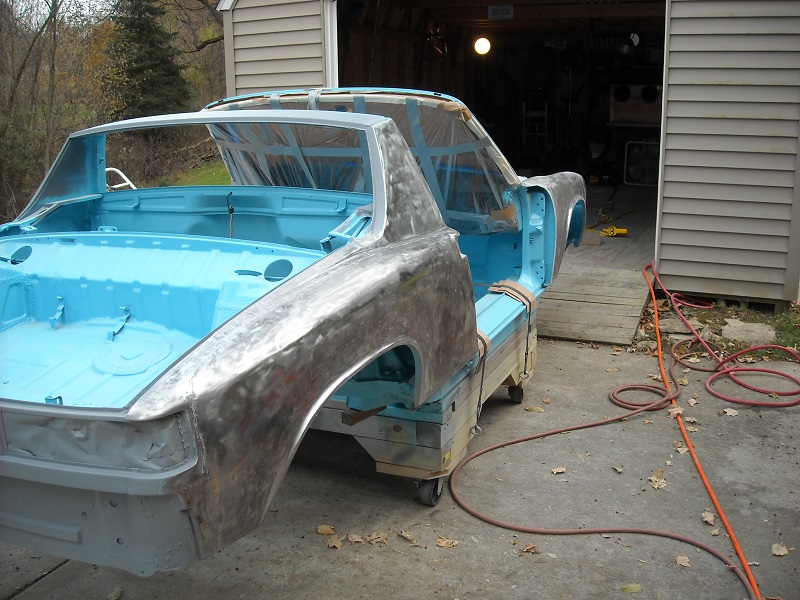

Hey guys, the recent bodywork that my wife did to my car is leading it to the paint booth. Which is giving me the chance to pull the fenders some. I don't want "flares". I want to keep the narrow body look. I have seen LaMonica's and like his. I just want to see some others to show the body shop.
Any pics would be greatly appreciated.

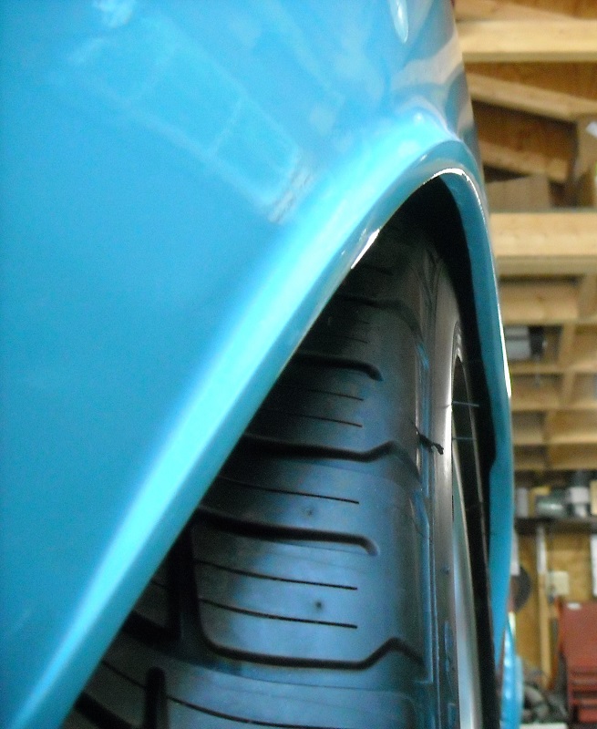

Hey Tom, When you ordered the flares from Chris do you remember how much offset you spec'd?
Chris offers them from 1" up to 4" wide - at least for the rear flares.
Olympic 914
post Mar 6 2023, 07:23 PM
Posts: 1,795
Joined: 7-July 11
From: Pittsburgh PA
Member No.: 13,287
QUOTE(live free & drive @ Mar 6 2023, 06:58 PM) *
I went with 1" on the front and 2 1/2" rear
If I were to do it again I would go with 3" flare on the rear.
They were installed at Tangerine, and I did the bodywork.
The 225x50s JUST fit on the rear with the 8" 951 wheels, can't fit a finger in there.
also tight on the inside, have 2mm spacers to reduce the inside rubbing
More info in my build thread, Link in the Sig.
