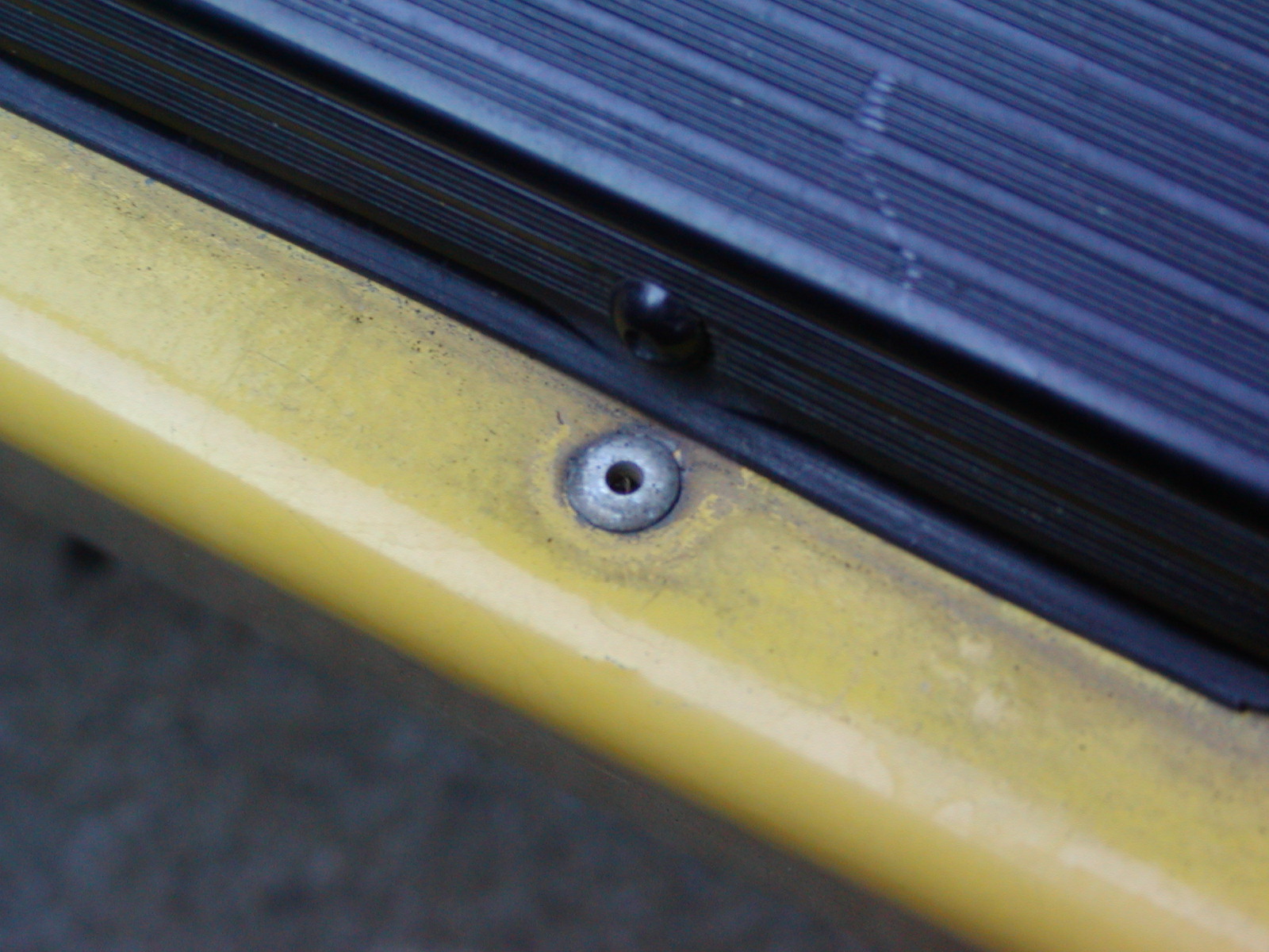

QUOTE(JeffBowlsby @ Feb 12 2023, 06:58 PM) *
Nothing precious or sacred about common aluminum rivets, I encourage you to R/R the rivets .
Mill finish aluminum rivets were factory stock on the 'rocker panels'.
NOPE (IMG:style_emoticons/default/dry.gif)
Ok Rich, tell me what you know. What I know is that the photo below shows aluminum rivets (with a peculiar head shape not available in todays marketplace from any place that I have found anyway) in the 'rocker panels' and black plastic riviets in the threshold plate as correct for a 1974 car. i *think* the clear plastic rivets are for 1973 and earlier cars.
Car acquired with ~40Kmi from the orig owner who told me the rocker panels had never been removed. VIN 4742914536

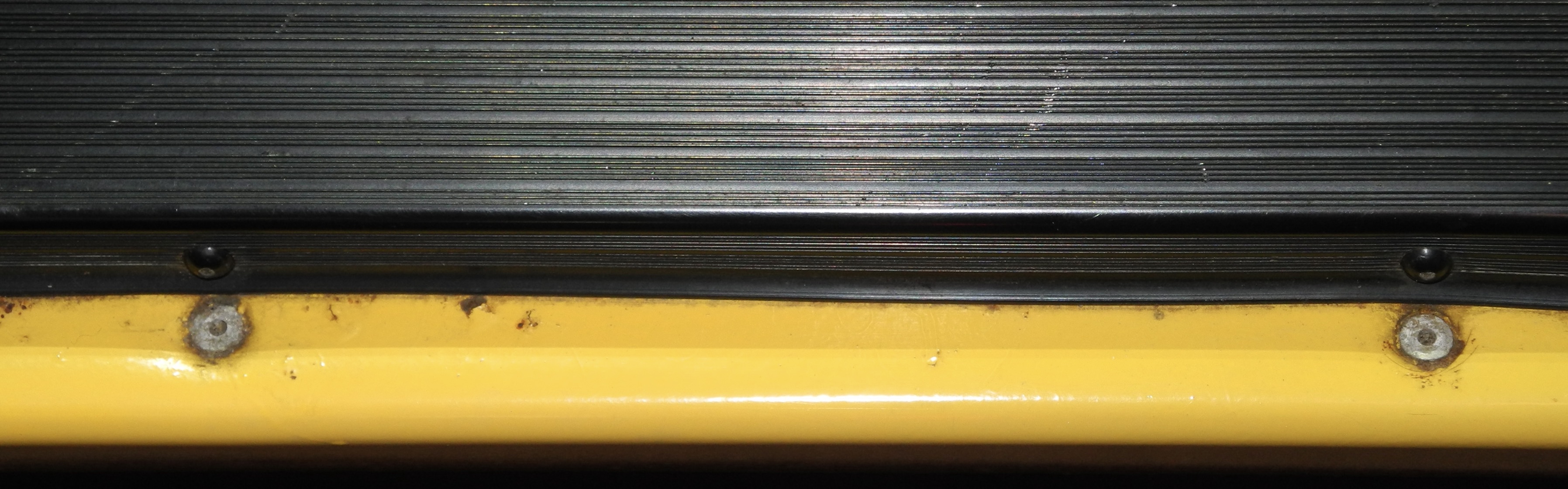

Mine look just like Jeff's:
Question?: If there is no precise replacement for the rivets, what is the preferred fastener?

914werke   The OE fastener is the Plastic rivet also used on ...   Mar 6 2023, 09:10 PM
