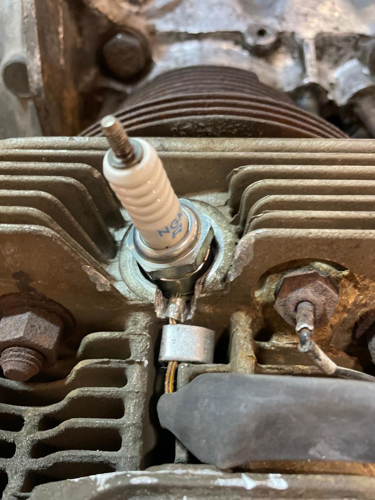

I'm getting ready to install a Dakota Digital CHT. Here are my questions:
1. What is the shrink wrap for on the copper wire? Mine came with it as shown in the photo. Do I shrink it once installed? It seems too big to shrink down over the wire.

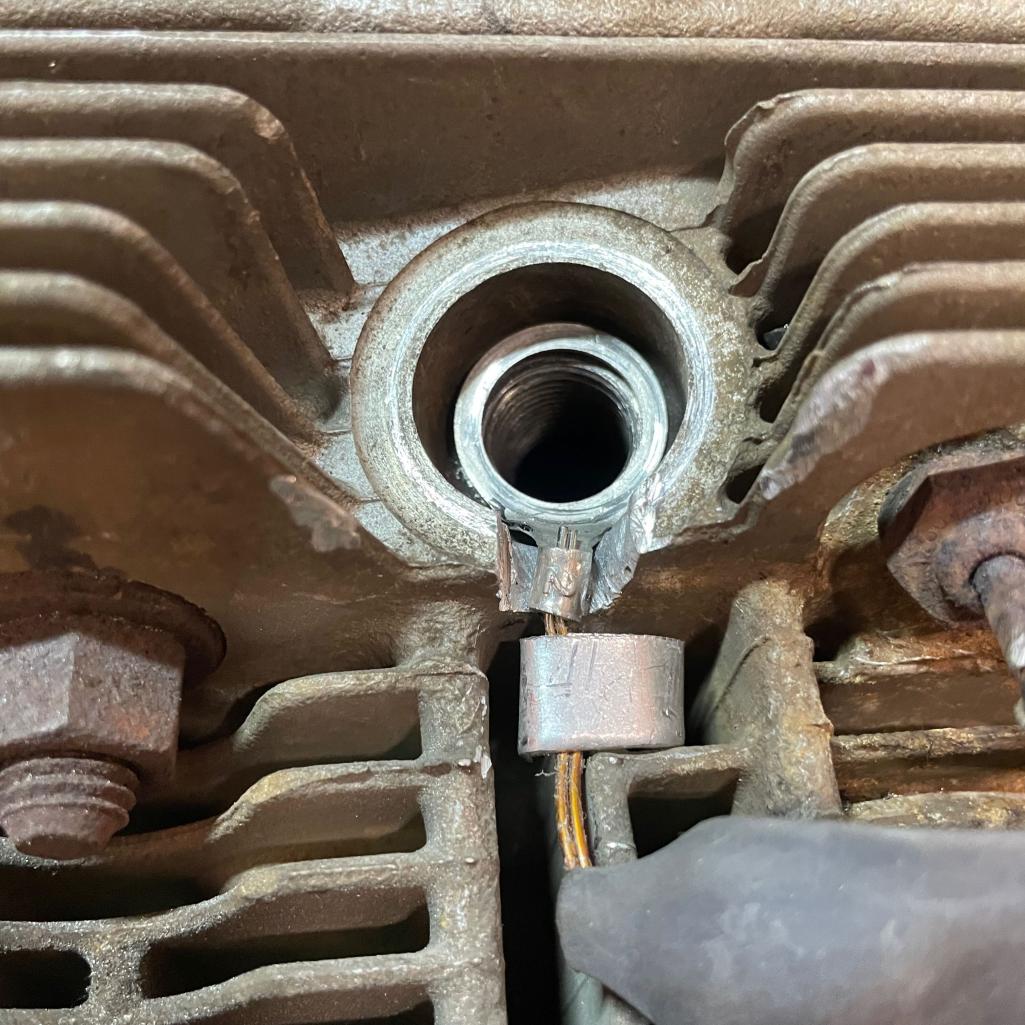

2. I'm installing this on #3 cylinder. Looks like I'll have to bend the spark plug connector. Has anyone done this, or must I grind out a space for it?
3. What circuit should I install this on at the fuse box? The red wire goes to "fused +12V with key on".
4. Is the blue night dimming input required? If so, where does it go on the fuse box?
5. Any tips for running the wire in the engine bay? I was planning on running the wire from the firewall on the driver's side, to the trunk wall, then along that to the #3 cylinder location. The other way would be along the fire wall, but then wires have to cross over the engine and a bunch of other spaghetti to get to #3.
Thanks!
-Jeff

I cut the channel. It seats in nicely with that done.

VaccaRabite   Grind/file a groove into the head for the sensor t...   Mar 7 2023, 06:46 AM

Chaznaster   I cut the channel. It seats in nicely with that do...   Mar 7 2023, 06:40 PM
914 RZ-1   The shrink wrap is on backwards. I just cut it. ...   Mar 8 2023, 07:30 PM

914 RZ-1   Back to my question: I bent the connector. I was ...   Mar 10 2023, 07:13 PM
FlacaProductions   I bent mine, screwed in the plug by hand until it ...   Mar 11 2023, 11:19 AM
914 RZ-1   I bent mine, screwed in the plug by hand until it...   Mar 11 2023, 02:58 PM
