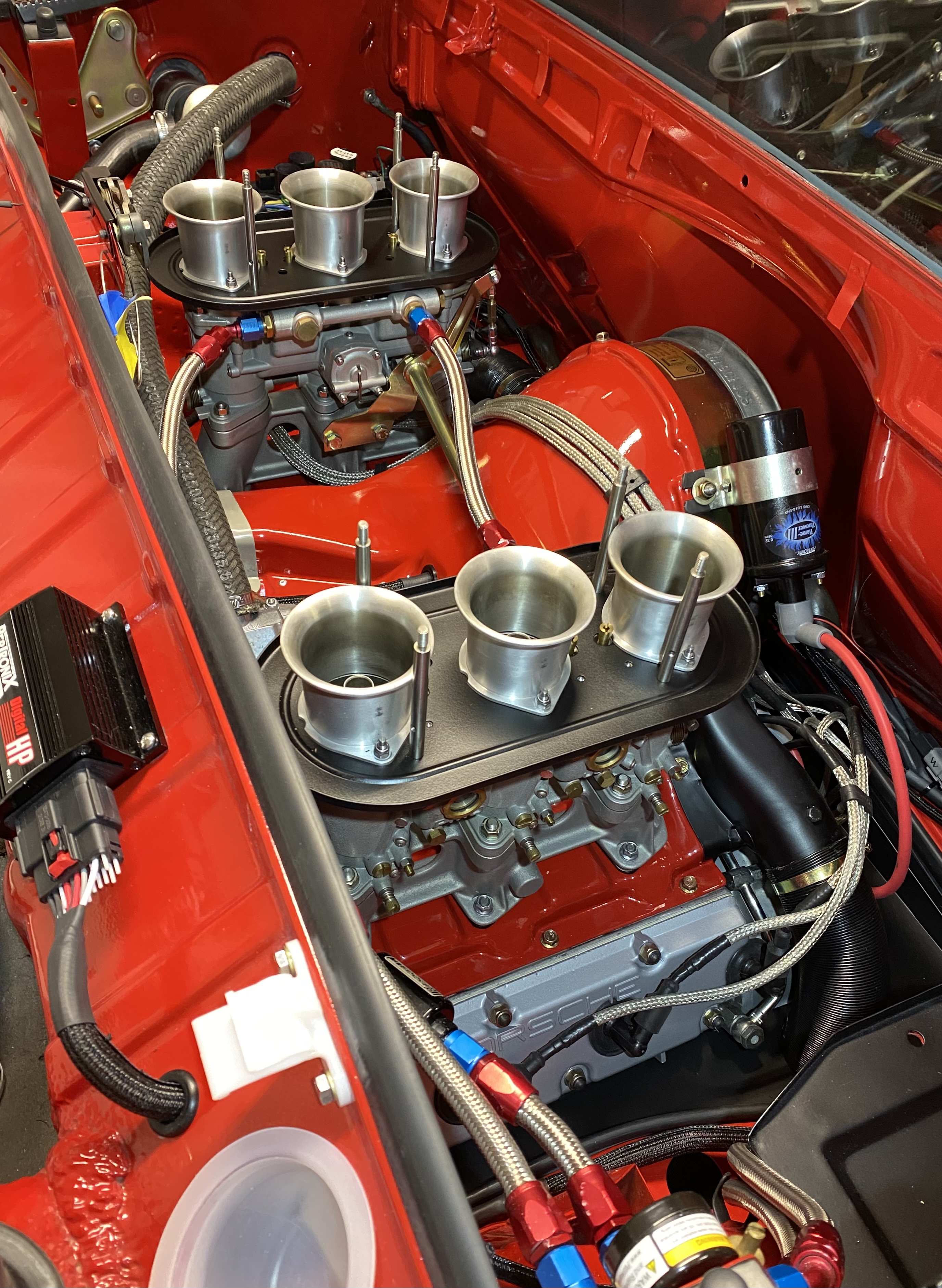

What about altitude? Many major mountain passes and routes at fairly high elevations that you don't want to miss. Cold start at 8-9k feet (IMG:style_emoticons/default/barf.gif) Always nerve racking to drive when carbs aren't running their best.
If fuel cost a factor, FI more efficient too.
As I'm just getting to the engine running, break in stage and pmo tuning, I'm already seriously considering the next step to modern FI. It's a pretty compelling option considering all the advantages. Not as cool looking but...super drivable. (IMG:style_emoticons/default/driving.gif)Attached Image
